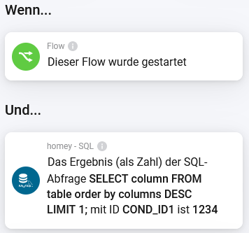

With test version 0.0.7 you can use a SQL query in flow conditions. Select one (!) field from your DB table and use the result (as number or text) in a flow condition. Compare numbers (greater or lower-equal; equal or not equal) or text (equal or not equal).
grafik

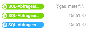

New test version 0.0.9:
  • Added a new flow condition for “SQL query was successful”.
  • Added capabilities/tokens for the quer result:
    grafik
    This capabilities will be set witch each query. You can use these capabilities as global token in your flow:
    grafik
Token:
grafik
grafik
