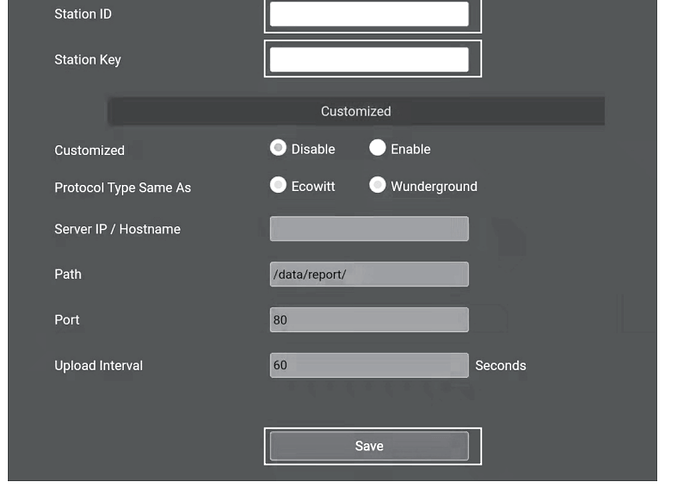

Question: Is this one supported?
Ecowitt WittBoy Wi-Fi weather station with GW2001 (GW2000) gateway (868 MHz).
or
Looking at the manual for the GW2000 gateway, it looks like it should be compatible as it has the custom connection settings:
I haven’t personally tested the app with this gateway but I would be surprised if it didn’t work.
