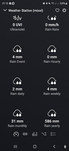

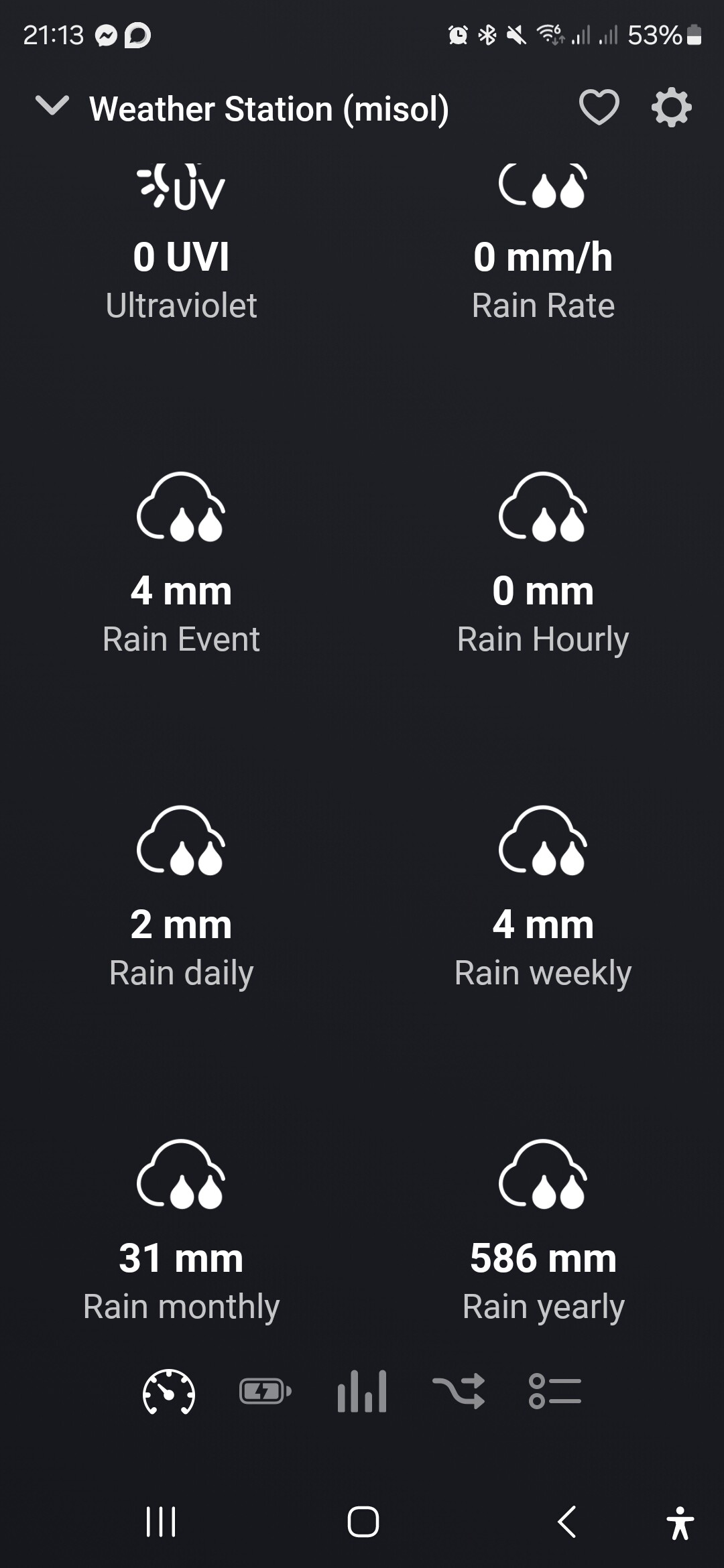

Sorry, I meant devices in the app, such as weather station, etc.
Google nest doorbell, ecowitt, hue lamps, somfy screens and sonos
Sorry again, specifically in the Misol and Ecowitt app.
That’s it. Does the rain gauge not show up in the weather station?
Indeed does not show up
Hmm, mine is in there
Damn you are right, apologies for not seeing that earlier. Thanks for pointing that out. Found it

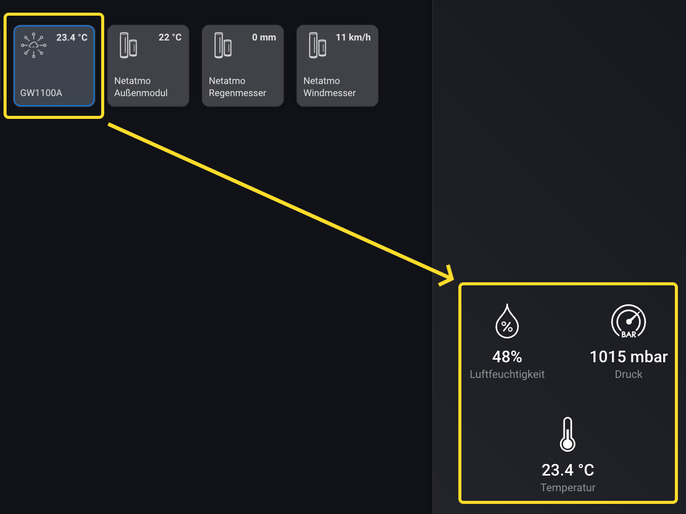

I added a weather station WS5500.
If you add a Temperature & Humidity device in Homey, does it find it then?
I guess the inside temperature, maybe also humidity and pressure, shown in the WSView Plus is provided from the gateway itself. So you have to add the gateway also in Homey:
Gents,
Thanks for the support. By adding “gateway” i can use the inside temp. Problem solved.

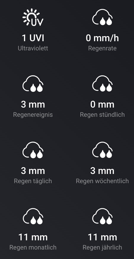

After I added the WS90 in Homey, no rain data was displayed for several hours or even 1-2 days for me either. But then the rain data were suddenly there. The problem is, I can’t tell you exactly what the problem was. Sure, I restarted the app and Homey, but if this was the reason that the rain data were suddenly shown, I don’t know exactly.
But what I can say, the WS90 is supported:
I see rain data now, too.

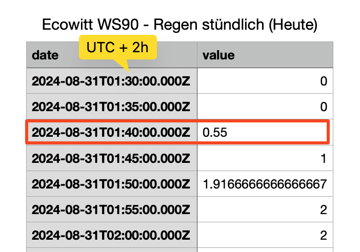

These are a few dats from this morning.
Acc. Homeys Insights, rain was first detected by the WS90 at 3:40 am, by the Netatmo rain sensor already at 3:35 am:
Acc. ecowitt.net rain was detected already at 3:35 am:
But, as we all know, the data are interpolated in Homeys Insights. The longer the time period, the more the data are interpolated.
