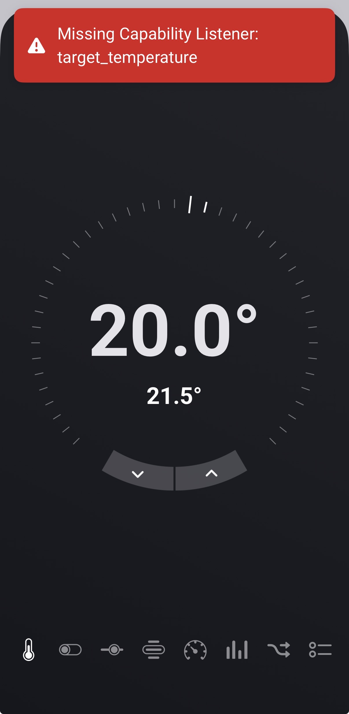

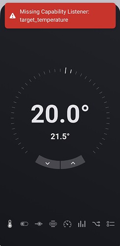

There is currently no communication at all with MELCloud home from the Homey app.
No values update and all commands fail, showing “Missing Capability Listener: target_temperature”.Homey Pro, latest versions.
Yes, the solution is not straight forward because the login handling is very complex, there might sometimes to fix at the token refresh level.
MELCloud Home implementation still in testing phase… thanks for your understanding. I’ll try to come up with a resolution next week.

I found the issue, fix in progress
Actually that’s the MELCloud Home web app which is down: https://melcloudhome.com

MELCloud Home should be fixed in the latest test version: MELCloud & MELCloud Home | Homey
Huge thanks @OlivierZal :raising_hands:
Confirmed: MELCloud Home works again for me with the latest test version.
Really appreciate the quick diagnosis and fix – great support!
