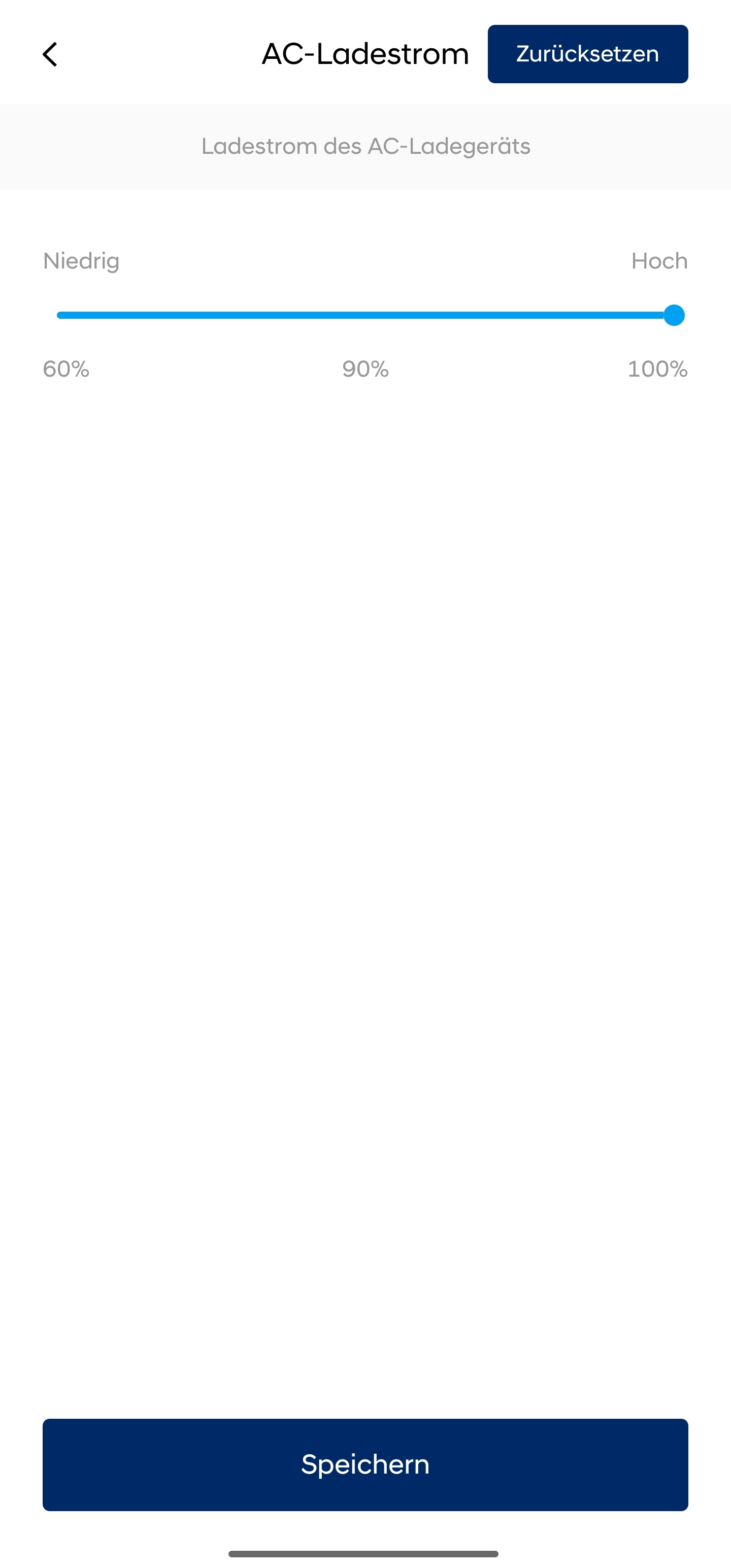

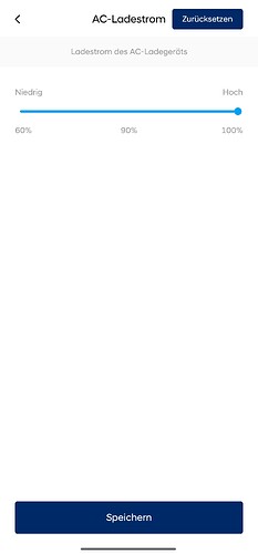

First of all, many thanks to Gruijter and everyone who works so tirelessly here! So far everything works great for me. Would it be conceivable to be able to control the charging current, see picture, via Homey?
I havent seen any controls for that. But I will doublecheck. If it is available I will implement it.

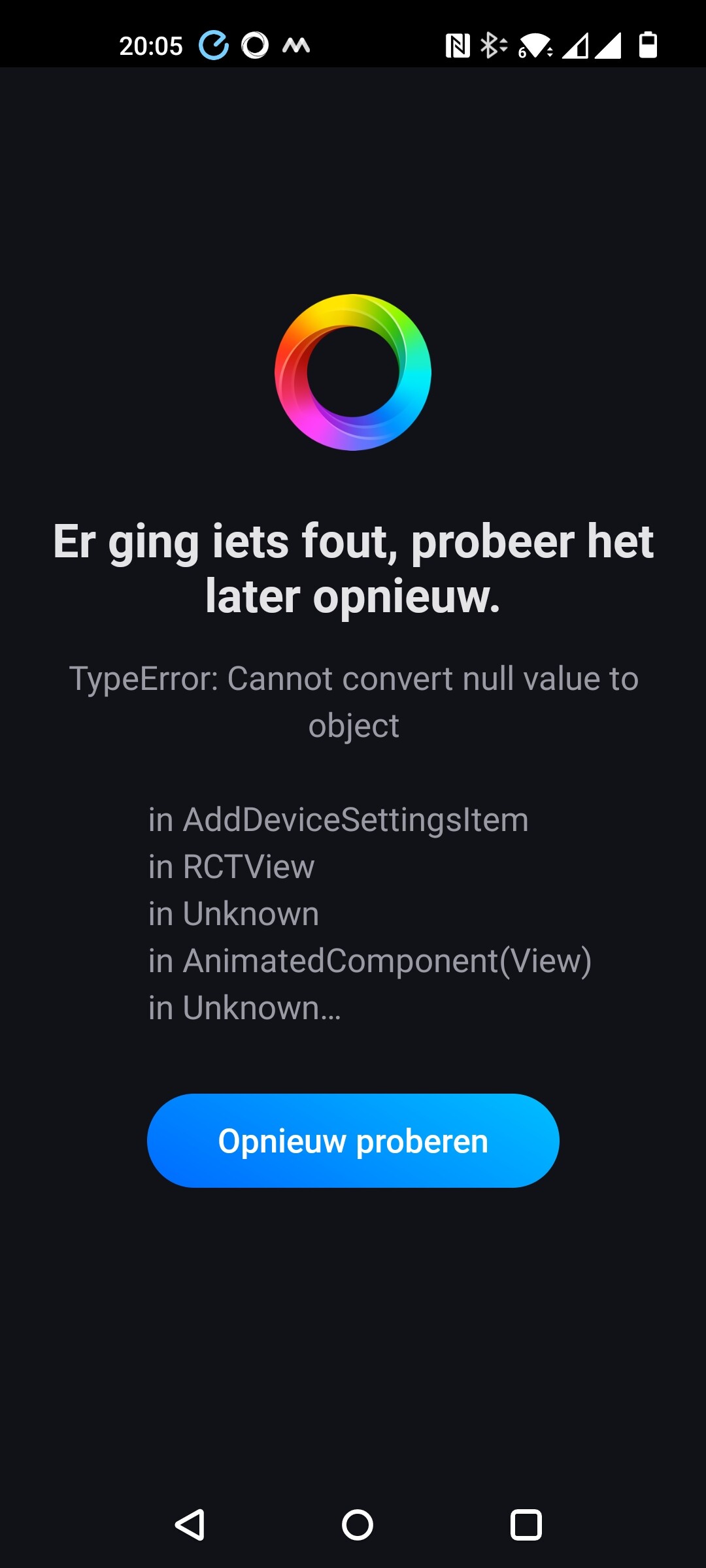

Hi got this error when pairing the car, but it does seem to work?
Looks like a weird one-time error. I dont recognize any of the app code in the error message. But it does work?
Looks like it is working

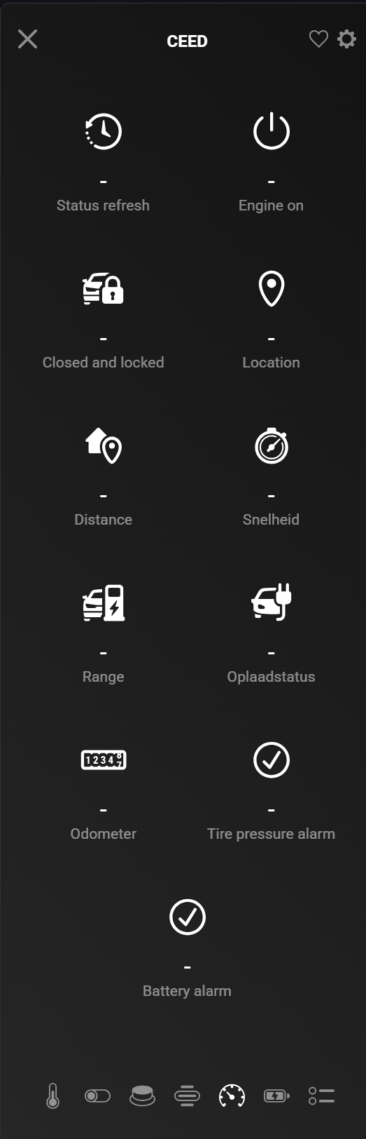

I’d added my Kia Ceed SW PHEV, somehow it stay’s empty. And the Enige type says Full EV, but it’s any PHEV :wink:
