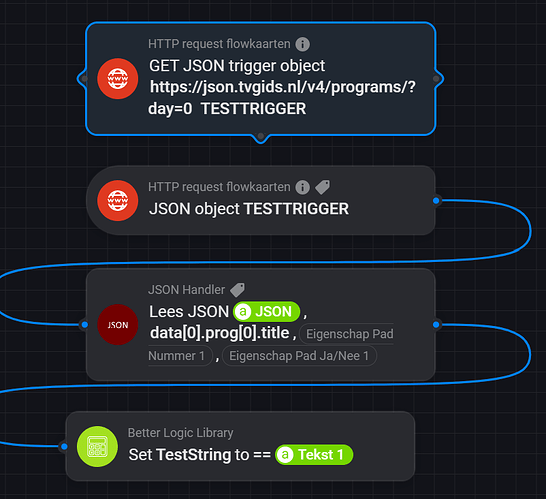

Well, first of all, you do not need to use the $ symbol, since the json is the starting point.
But, it will still not work, i think the jsonfile is to big for the Logic HTTP Get?
Because, i cannot place the answer/value in a variable or a BetterLogic variable.
The left side of my picture doesn’t work at all!
However, when you use the right app side, it does work.
Also, this works fine:
Meaning: It’s a “bug” in the default Logic Http Get card.

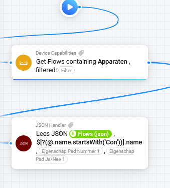

Here, a json with an array of flows returned from the DC app.
The JSON handler app searches for the first flow with a name that starts with ‘Con’ and returns it’s name.
