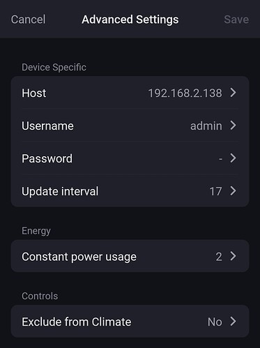

@sorted.bits Hello Wim. Thanks for the great app.
Due to other issues, the IP of the gateway changed.

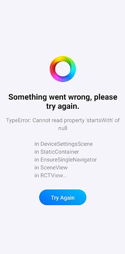

But when I want to edit the thermostat device using the mobile app, this screen below pops up.
After hitting “Try again”, I can’t do anything, a fixed reload sign appears.
I have to force close the Homey app to be able to use it again
A Homey reboot didn’t make a difference.

A reset of the gateway worked, and it’s added to homey but I have the same hang as reported before, unless I use the web app.

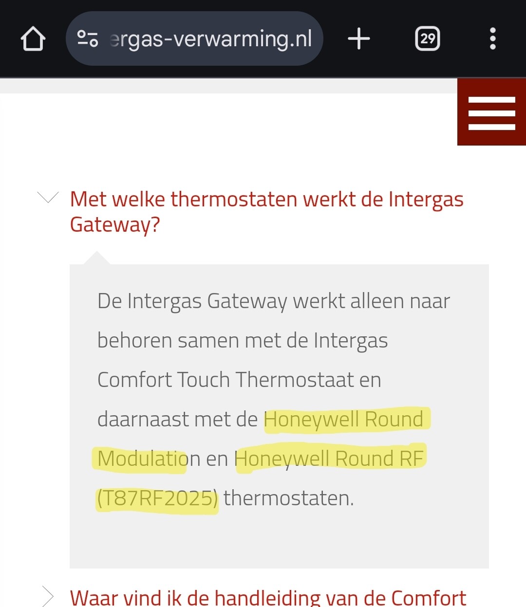

I’m not sure which thermostat you own atm?
The gateway uses RF to talk to the boiler.
These are valid thermostats as well:
Honeywell Round Modulation and Honeywell Round RF (T87RF2025) thermostat.
I use a Honeywell Round Modulation T87M2018 and it works fine with the gateway.

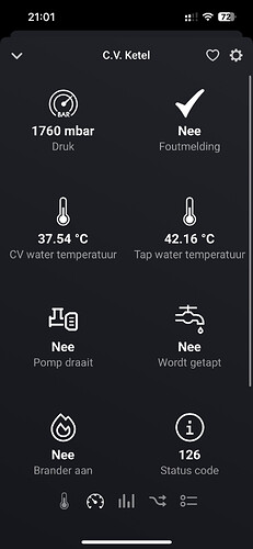

my tap water temperature shows 0 degrees. while my boiler is hot.
