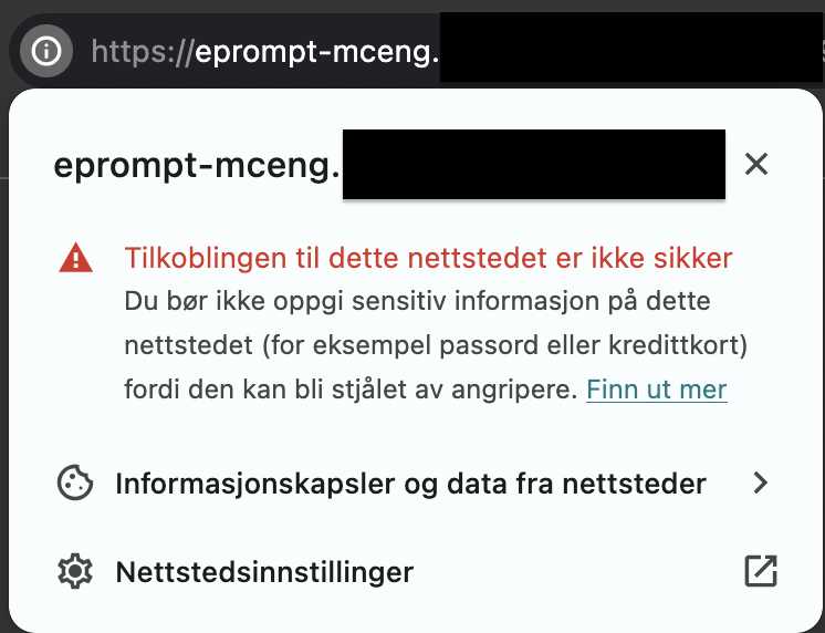

That’s strange, it’s a link from my work planning system. When I put this link in safari or chrome or put is in a calendar app it is not giving your error message. Is the IcalCalendar app more untrustworthy then these apps :wink:
How did you produce this error message? Because I think I need to contact my work to fix the SSL certificate?
I opened a new empty chrome tab, pasted in the url for the ics file. After the ics file was downloaded i clicked the i icon next to the url.
I tried the same with my ics url from google which also states it uses an unstrusted certificate, which i know they dont, so i guess that method isn’t correct.
Found this StackOverflow article, the error shown when trying to fetch the ics from your url is probably because the site is using an SSL certificate signed with a chain which isn’t publicly available.

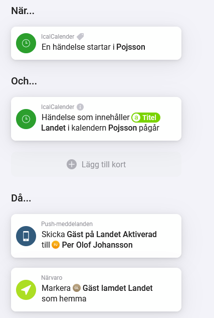

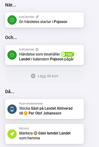

Does it find a day event with the Title ?
Tried to get it working with
What am I doing wrong ???
Is There any scheduling examples for starting an event over more than one day to start at mid day and end on mid day for the last day ???
IcalCalendar can indeed find a day event with the Title tag, but you are doing this wrong. You are telling the And card to check if an event with the name Title(from the When card) + Landet is ongoing, which i’m guessing is very wrong.
I’m assuming you want to know if the started event has the Title equal to Landet.
Swap out the And card with a Logic card like shown in the picture below.
