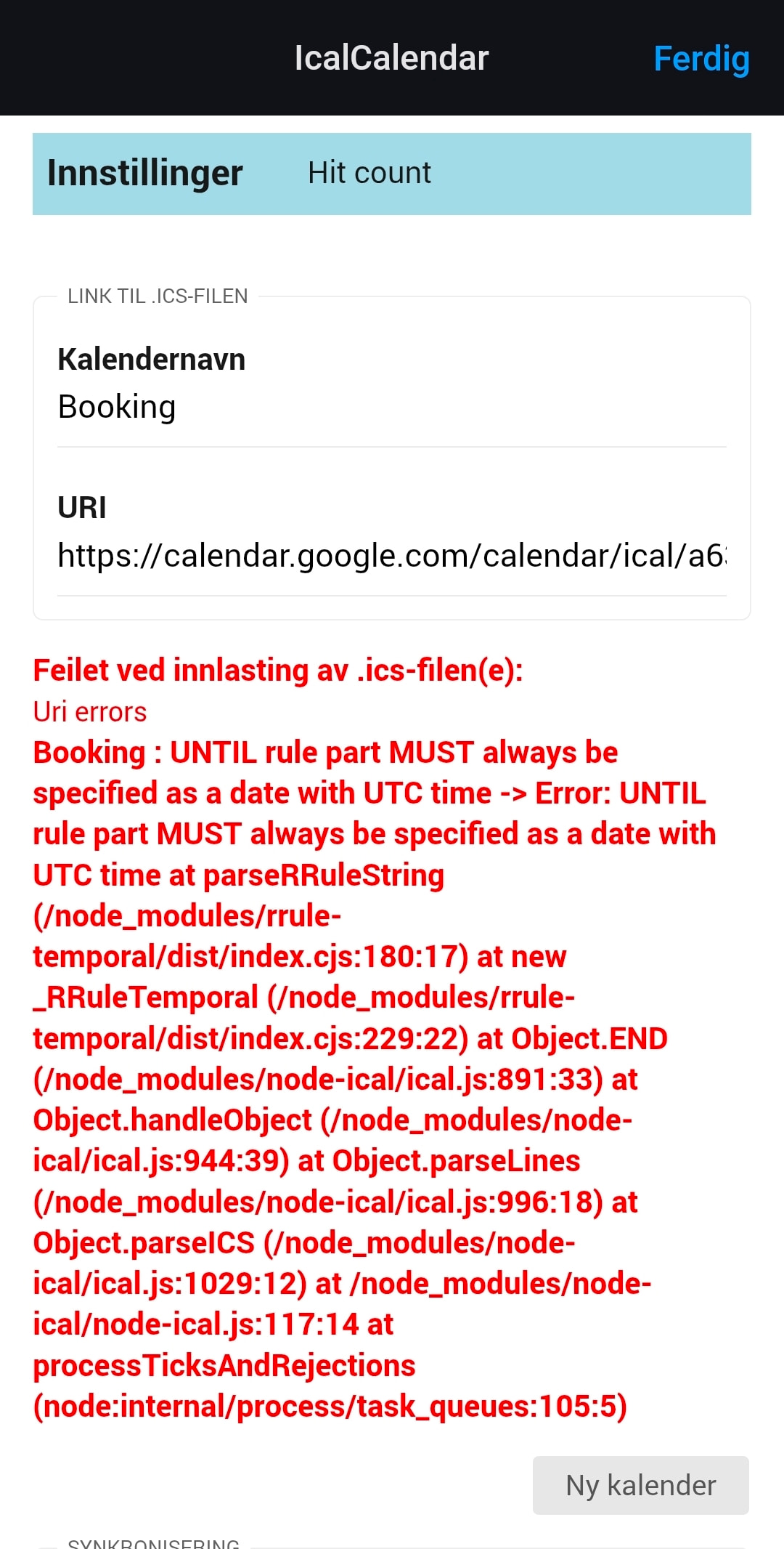

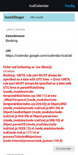

Hi, the app crashes and won’t start after updating to 3.0.1. It gives this error message (from the configuration menu).
The calendar I’m pulling is from Google. Homey Pro 2019 v12.10.0.
I have another Homey Pro 2019, running a different Google calendar, and this one works. Any idea what’s causing it? I can download the ICE file in the browser. Should I file a bug report in GitHub?
I get the exact same error, when I try to use the “get event -index number- of calender -name-” card.
Here is a diagnostics code: 3cc90197-6ca4-4bc0-8930-3b7a40309b55
Ahh. Okey. I’ll look into it
The npm package i’m using to parse the ics content (node-ical) has a lot of updates. That error is comming from an npm package that node-ical again relies on for parsing the RRULE string on recurring events.
Yes, please create an issue on github and i’ll see if i can find out if there’s something any of the npm packages can or should fix
Okey, thanks. I’ll look into it
This is fixed in v3.0.2 that’s just released.
Also, it seems that Homey has changed the way HomeyScript programmatically calls a flow. The HP19 script does not work anymore, and the HP23 script seems to work on both Homey 2019 and 2023. So you might need to update your HomeyScript in your flow
There was an issue in the npm package i’m using to parse the ics content. Some of the issues have been fixed, but there’s still some RRULE issues there. Please try the new version 3.0.2 that’s just released.
