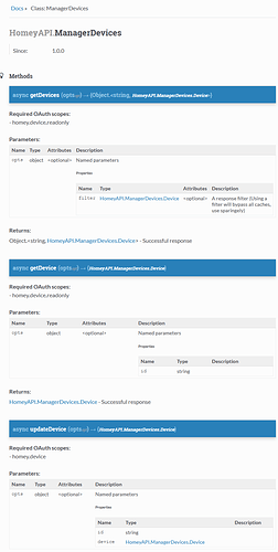

Homey script is pretty limited in what it is allowed to do in Homey.
Example: it can only get devices, but not update any devices.
So unless you can give an example what you are trying to do that is “advanced”, it is very hard for people to help you.
It can’t update devices? But I am able to do things like turn the lights on/off change colours etc. with HomeyScript. Or isn’t that your definition of updating devices?
you can? thought only by activating corresponding flows you could do that, not by updating other app’s devices, as it didn’t have the permission to do that.

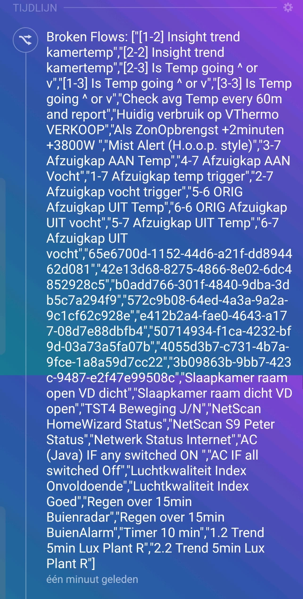

Flow:
Timeline:
Only the names:
