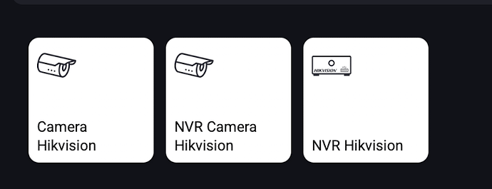

  • New UI for camera pairing
  • Initial support for NVR and its associated cameras (events not supported yet)

Did you properly create your cameras as NVR type?
Yeah created the cameras through the NVR. The off and on command for the NVR doesn’t do anything though and checked through the network/advanced settings of my NVR and don’t see anything related to my homeys IP.
