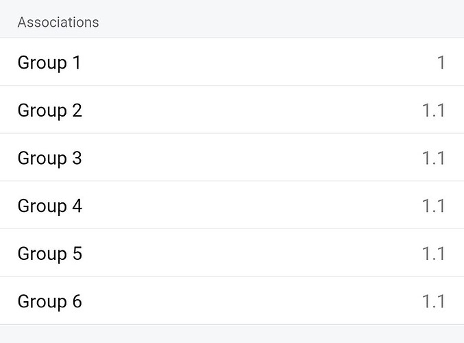

I want to use the 2 sensor inputs on the Z-Relay. I got 2 NTC 10k sensors. Turned off power to the Z-Relay, mounted the sensors, and power back on. In the device settings in Homey I chose ā€œ10K NTC connectedā€, 60s interval, and saved. I’ve waited an hour and I’m getting no sensor readings. Tried restarting the Heatit app, no difference. Any ideas? Should I restart Homey? Should I do anything about the ā€œGroupā€ settings? (currently set to default: 1.1)

Could you attach a screenshot of your association list?

Thanks, I’ve added the association list screenshot. I’m using these defaults, I haven’t changed them. Today the Z-Relay became unreachable again, and I had to remove and re-add it. It hasn’t worked continuosly for more than a week, before freezing. (The Z-TRM3 keeps working fine.)
And which software version is on this Relay?
