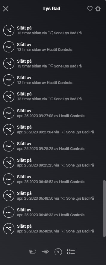

Hi, sometime my Heatit z-dim turns the light off just some seconds after it have turned on. as you can se from the log its turn on by a flow. (sone active) and turned off by "heatit controls right after.
I have Homey Pro 2023. and App V3.4.2.
Somethimes its working as it shold also. This is from the same day (today)
Turned on and off by sone activity / inactivity

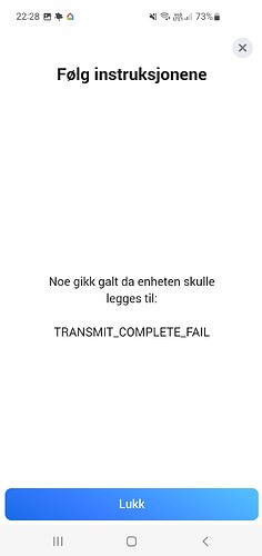

hello, I have problem add my z-smoke detector 230V to my new homey. see my screenshot. Anybody can help me please? adding to old homey model was no problem. thank you
Happens to my single relay too. Got both green dots, and then something went wrong. Have heard that others also have the same problem on early 2023. Goes straigth in on my old 2016
and what shall we do? send this message to heatit homey developer? or buy old version homey? :slight_smile:
