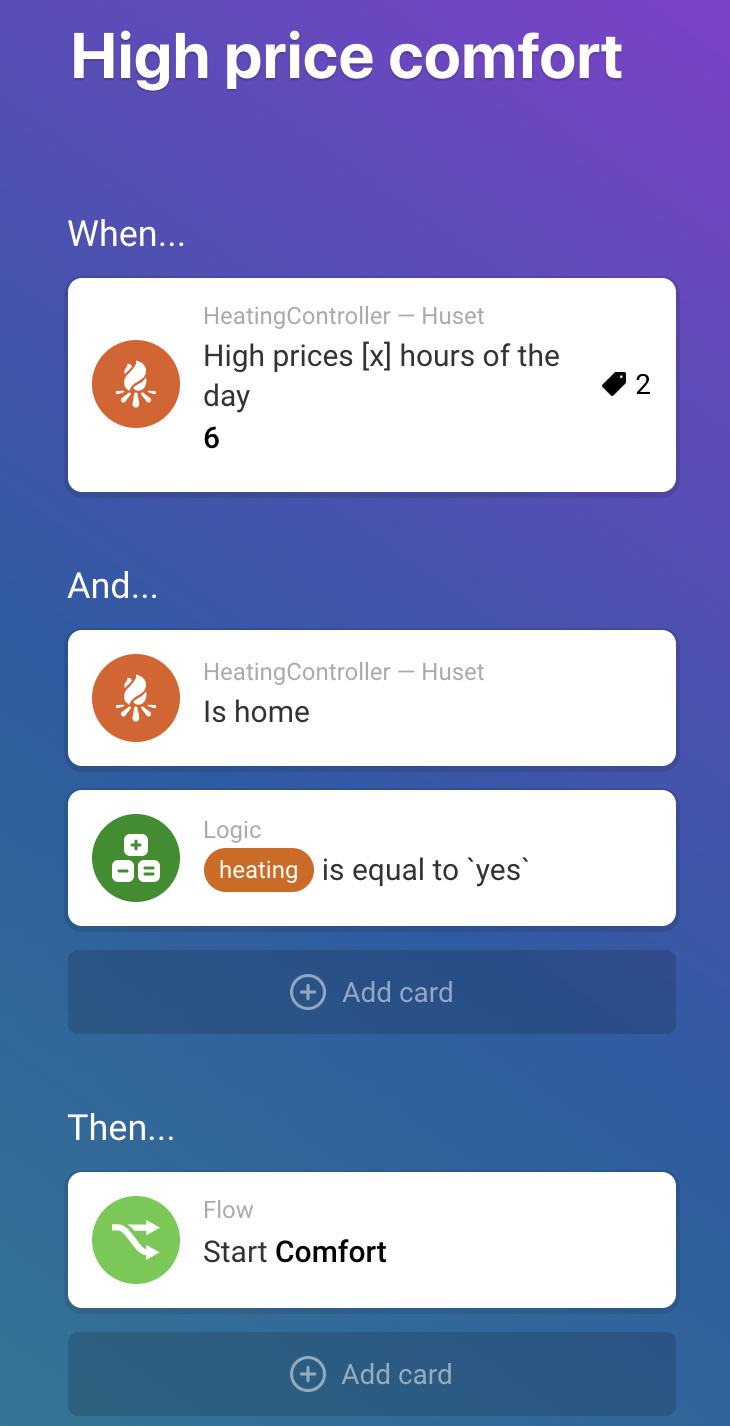

I can’t seem to get your “High price trigger 6 hours - Comfort” example to work.
It’s active all the time instead of just 6 hours, shouldn’t it use the Comfort Mode settings if the price is low/active more than 6 hours? Or am I missing something :sweat_smile:
I’m using “heating is equal to ‘yes’” myself. Not “heating is true”… so the example might be wrong.
And this is the target temperature:
Yes, that I was aware of.
Maybe I am misunderstanding the function. I was under the impression that when there are high prices 6 hours of the day it would regulate the temperature down a couple of degrees, and outside of the 6 hours it would use the temperatures set in ‘Comfort mode’ rule, or if it was 2 consequative hours it would skip.
Because right now it only regulates in ECO similar like your graph and during the day it is fixed at the temperatures set in the ‘High price comfort’ rule. Should I use the same rules as I use in Eco for comfort as well, but opposite?
It finds the 6 hours with lowest prices when in ECO mode.
You can add several HeatingController devices and set separate schedules, if that’s necessary.
