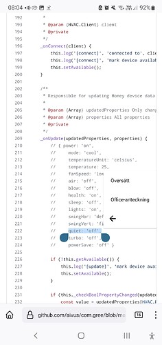

@aivus Great app! And I was wondering if it is possible to add the silent option?
I have made some fine working flows with your app and most of the time we like pur ac on silent. So its kinda inconvenient to still take the remote and do it manually. Thanks for your great work!
@Niels_van_Dongen I have a ticket for this, but currently don’t have a time to work on it
Yes. Known, but have no fix :frowning:
