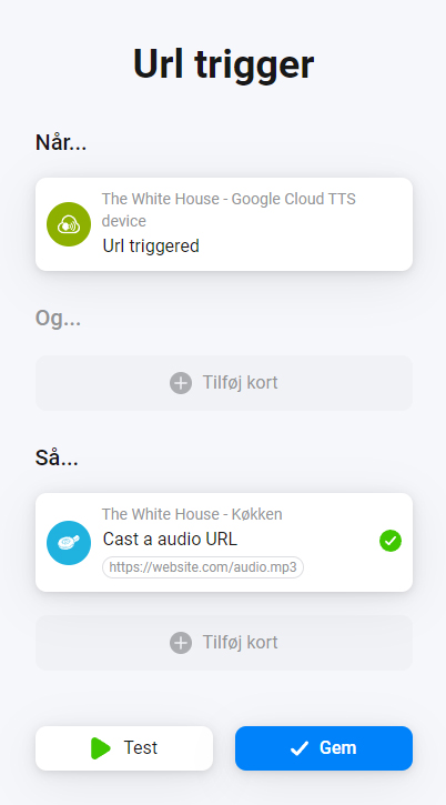

You can place the URL in a Text Variable: and place the Tag of this variable in the Then flowcard:
translation: Cast een geluids URL = Cast an audio URL
Hey Dalle,
Keep in mind that the URL is not fixed! The Url will change everytime the speech-text (or settings) are different.
So just put the Url tag into the Cast an audio URL like JPe4619 showed, and every time you start a speech you should hear the correct text.

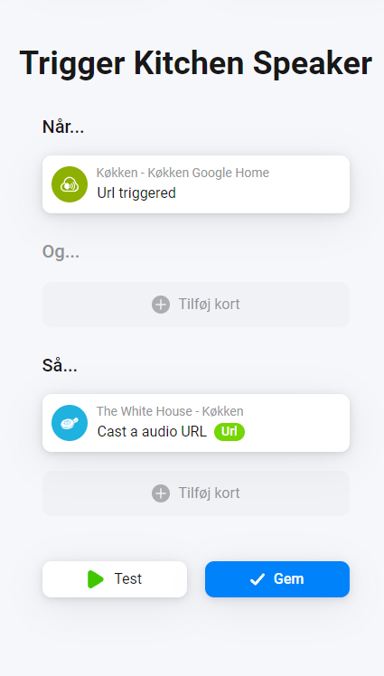

Thanks but I have tried exactly what you have described, but It still seems to repeat the tts that it has used.
Like when the door is open for over 1 min. it will say “The door is open” and when I then turn off a sensor it should say “the sensor is off” but if the last run action is feks. “the door is open” when I turn of the sensor it will say “The door is open” if I then turn off the sensor ones more, then it will say “the sensor is off” so it seems like it always starts with saying the last used tts, before it will us the right tts. Hmmme weird.

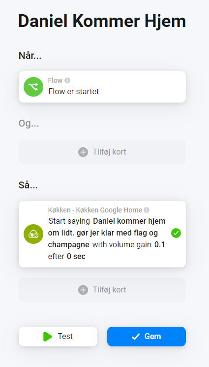

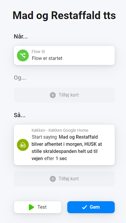

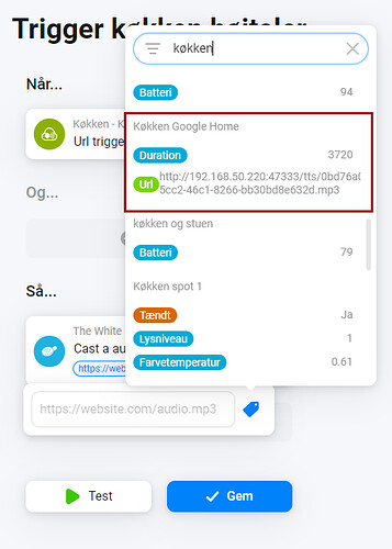

Here is a more visual way to se what Iam doing.
The først flow is my kitchen speaker, if I start runing the thirst flow then it will say the message then if i try the second flow it will say what ever it was in the thirst flow, but if I run the second flow ones more, then it will say what is in the second flow, and that will just keep on if I chose anouther tts.

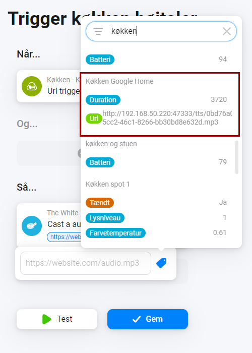

Are you using the local Url TAG or the url as device property?
I´am using the URL tag that is under the “google cloud device” that I have added to use with my kitchen speaker, and I can se after it has run it has a lokal url, but I can´t see any outher options then that url tag to use with the google cloud device named “køkken google home”.
I think I have got it working by using the stanard url tag instead of the one that is under the google cloud device. :slight_smile: but it looks like the standard Url tag is also local, so I don’t know why it works with that tag and not the one from the google cloud device. :blush:
Because its a bug (apparently) that i will fix :wink:
Great thanks again, and good work wtih the app. Right now it is my favorit and it funktions very well. :slight_smile:

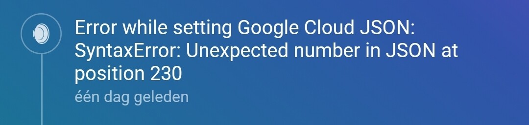

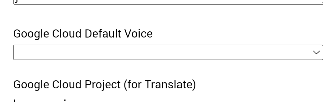

After my homey broke i have to configure the cloud text to speech again.
I have entered the JSON, but now i can’t select a voice for speech?
Anyone who knows how to solve this?
Did you try a restart of the google app after setting the json file?
I did restart the app.
There is an error i get about the JSON i entered
