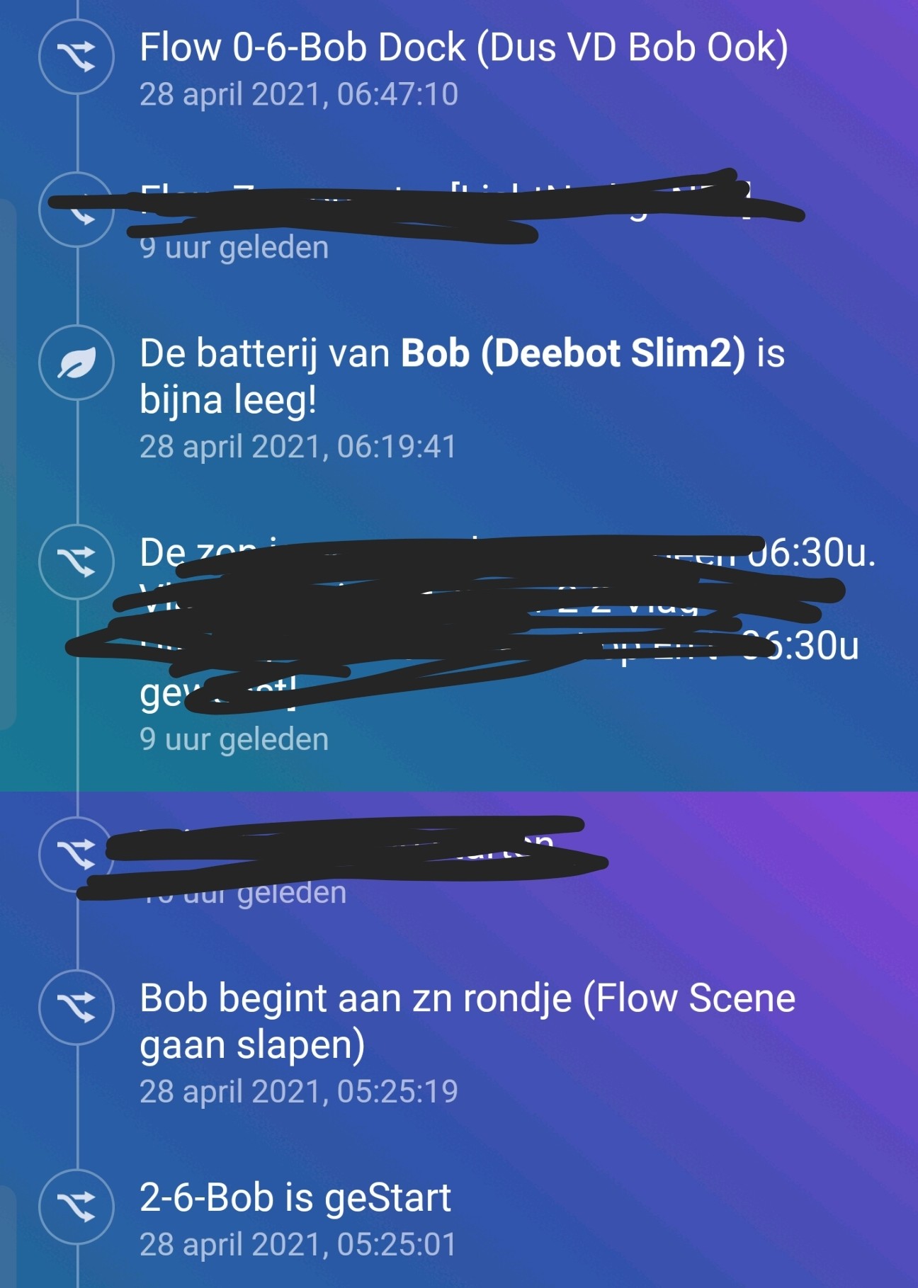

success! Deebot Slim 2 is now recognised after removing and re-adding to the app. cleaning/docked/charging/etc seem to work through Homey as well. will test a couple of flows and report back. thanks for your hard work so far!
Update 2: Ecovacs app says Deebot offline, Homey “start Deebot” command works anyway :smiling_face_with_three_hearts: :heart_eyes: :upside_down_face:
Update: forgot to mention the Battery monitor also works!
Superb!
My Deebot Slim 2 is working like a charm!
And, it was still online, so it’s 100% OK and functional. Even the “spot clean” function works.
No need to remove and add device again, I just installed the new version.
