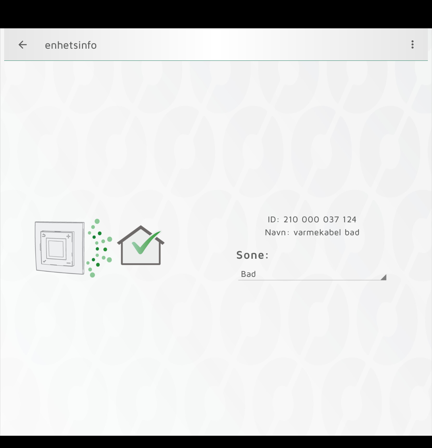

from the log I see that the hub is found. but then there is something confusing with zones, rooms and devices. do you have the nobø app. see if you may have set something up wrong there. you must have a device in a zone for you to be able to find them in homey. I am attaching a screenshot.
Yes, well one thing that is a little bit confusing (to me.at least) is that the zones in the nobø app is called devices in the homey app, but i have assumed that is correct.
I have at least one device in every zone in the nobø app, in most zones I have several. The only “odd” thing I had was a button for control of all zones (global) that was not in any zone. I have moved it to a zone, but that did not change anything.

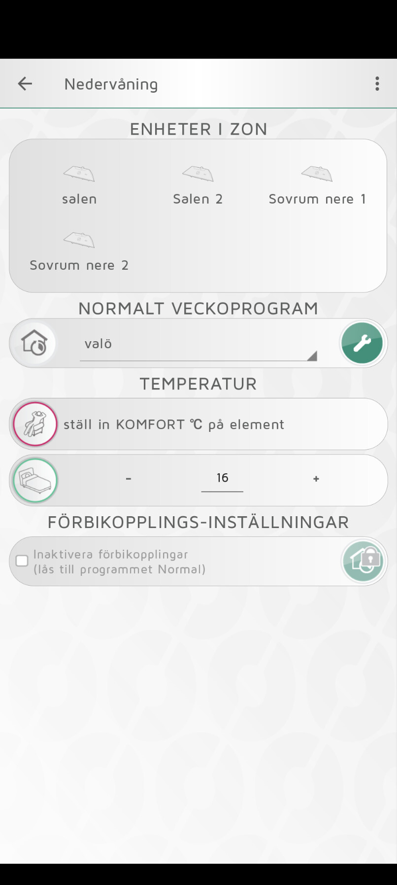

Below is the zone “nedervåning” that i can see in the homey app.
I’m not sure why you can’t list devices in homey.

All in all it is 7 radiators, one remote/sensor and the hub. The devices are located in 3 zones. One zone has only one device, the rest of the devices is split between the other two zones. In homey I have the 3zones and the hub listed as devices (i.e there is no trace of the individual devices in the zones in the homey app (where they are called devices).

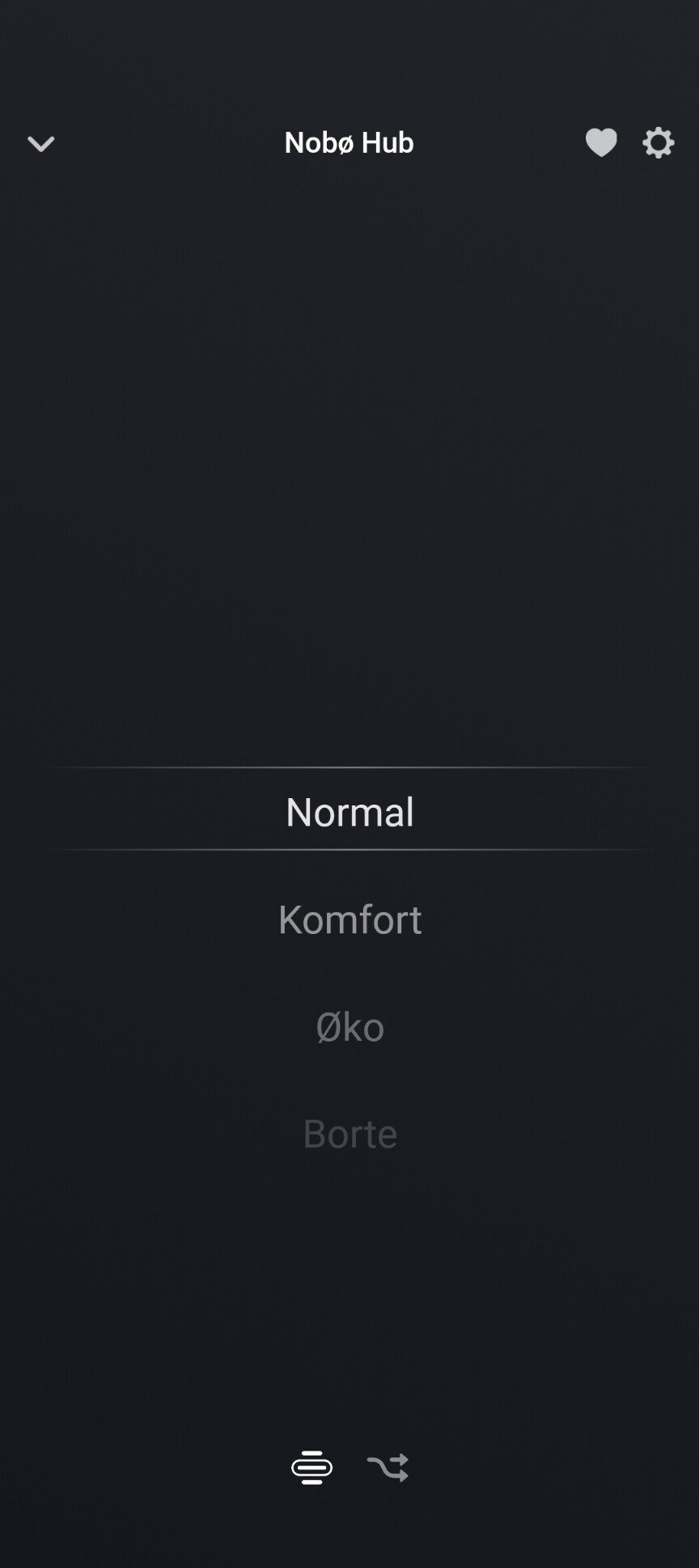

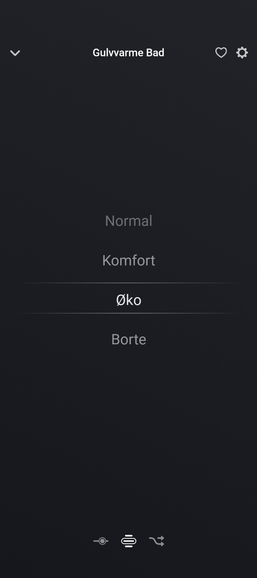

All zones (devices in homey) behave the same, they all show information (like below, a zone with several devices - but the one containing one looks and behave the same), and if I change mode on a zone, regardless if its the one containing 1 device or the ones that has several devices (or on the hub) from “away” to “normal”,
I can see that the change is executed as it should when checking in the nobø app. So, it seem to work just as it should, apart from the part that I cant see or select anything in the dropdown when creating rhe flow.

Yes thats correct, you control the zones and not the device directly in Nobø. And a global control on the Hub device in Homey.
I added a final stable version that works on both Homey Pro early 2019 and Homey Pro late 2023. I have tested it to work on both. And users has confirmed thats is working.
Zones can now be set by using the flowcards for that. Dont matter what room it is in the selection.
Remember to set the Hub device in first, then the zone and the mode.

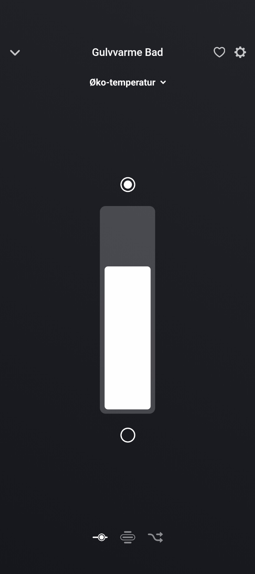

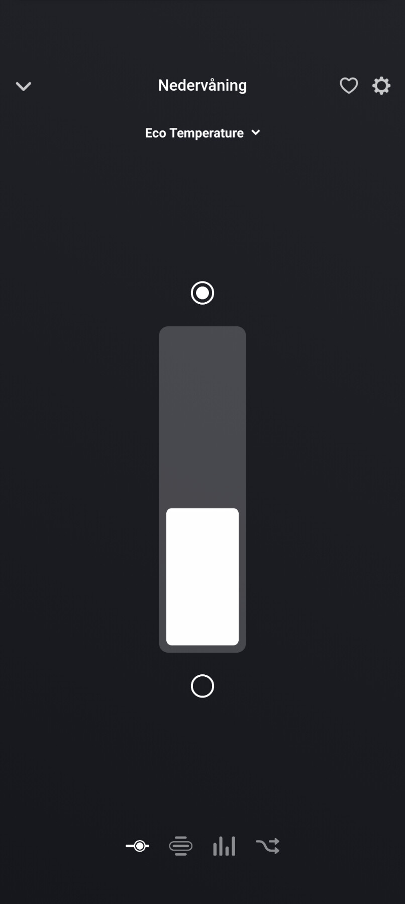

I have implemented a new comfort temperatur UI in capabilities. This is useful for controlling the heat better in Homey, or Google home and Alexa if you have that.
But Nobø dont report any live temperatur so i have added a little hack to it.
In version 2.2.13 (currently install test) you have the option in the device settings to turn on to report a temperature from another device like a pir sensor or other sensor you have nearby to add.
You will then get an extra action flowcard to set it up.
Ill add some screenshots:
