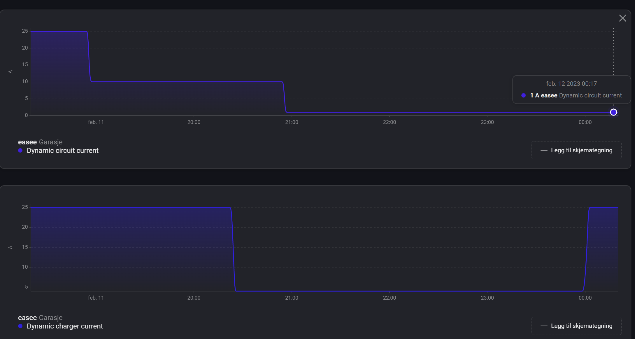

Hi Richard, noticed today that the variable in homey do not update when Direct circuit current is changed. Here DCC in reality is 25A, but insight did not catch that. It is presented as 1A
It appear to be about one hour delayed
@Richard_B , was this fixed in 1.6.1? If so, I will update from 1.6.0

I hate bothering you about this again. The delay of Dynamic circuit value really cause issues with my smart charging. The flow rely on accurate information from the charger. Hope to see some fix in the test version soon :pray:

The slide bar shows the dynamic charger current, not to be confused with the dynamic circuit current. The mobile app seem to show it correctly, not sure what is up with the web app. When I update the value using the mobile app then the web app catches up…
