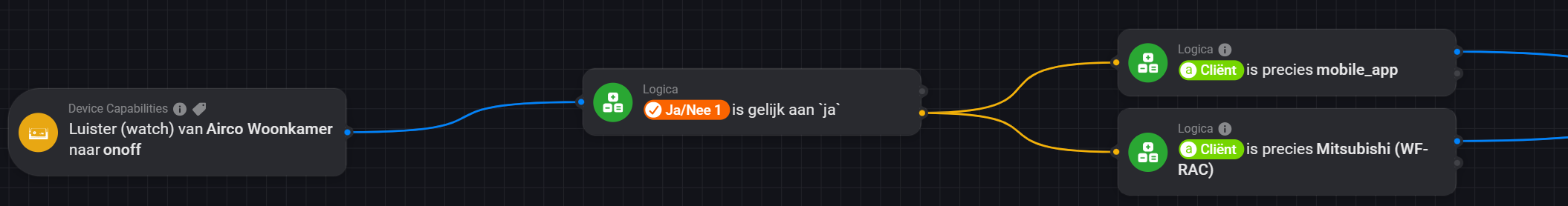

Since i’ve migrated (Thursday) to the new HP23 this flow isn’t working anymore. And i have no idea why…
This only has to trigger when the AC is turned off.
Add a notification or log card to the blue ‘nipple’ of the logic card and / or the trigger card, and add all the local tags, to see what values it returns?
Hi Peter, thanks for the tip.
I created a new simple flow below, not mutch info is beeing displayed. While this was the case 2 days ago (HP19).
ps it also seems that the onoff is changed to aangezet (dutch for on)
I don’t have time right now to test it, but you can create a supportticket if you cannot fix it.
But, what you can do:
Just use the default on/off When cards from the device.
Then add to that one the Get Insights from 0 minutes ago flowcard from the DC app: It will give you the same User/Client/etc tags.
And it saves memory :wink:
Thanks i’ve switched to the then card and this works perfect :smiley:
