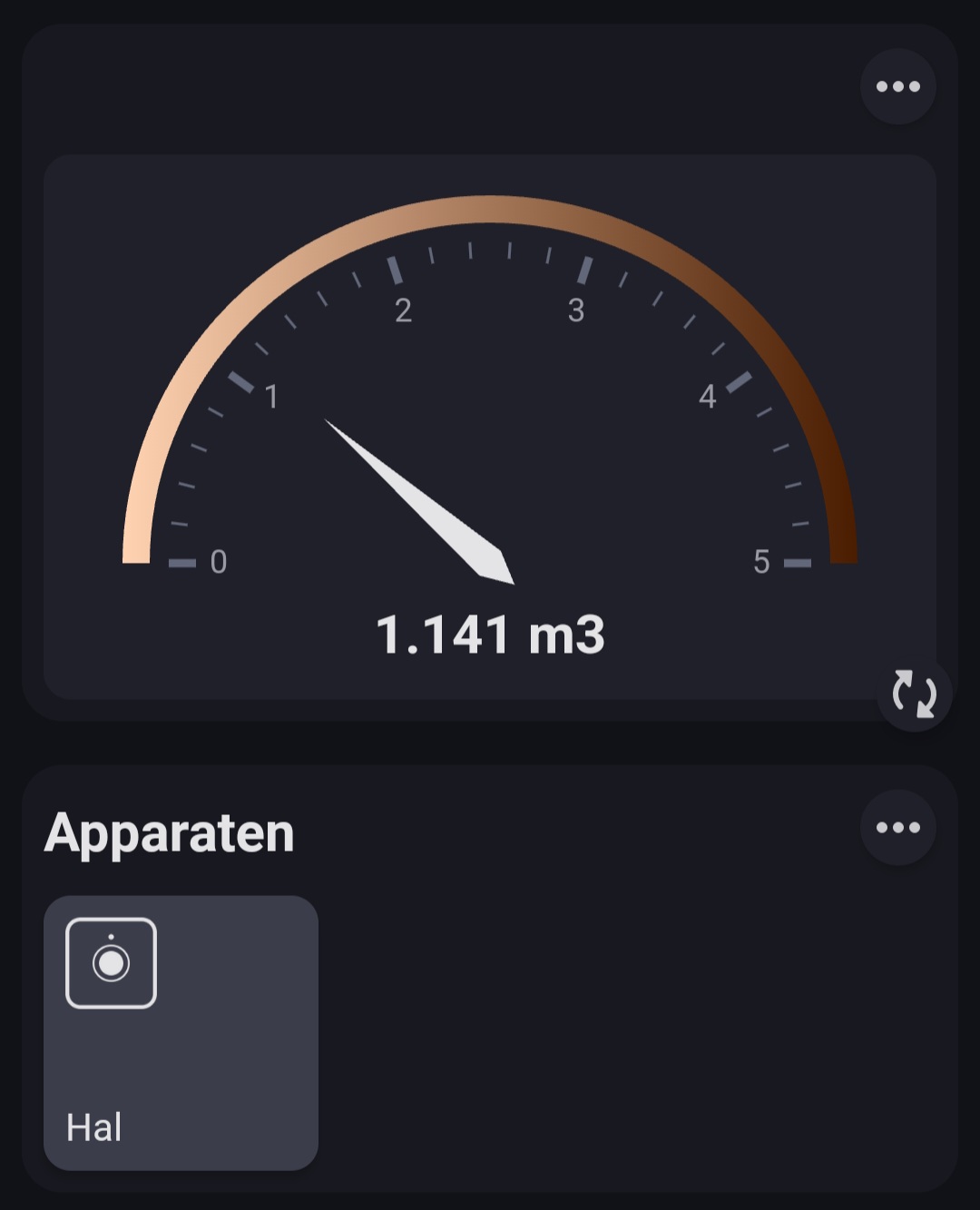

I believe that’s just a small tile in a full width widget. If you go to the dashboard edit screen, you should notice that the device tile is in fact part of a full width widget. There can’t be any other widget next to it.
I may be able to allow the widget to be smaller, but you would still be left with empty space to the right that can’t be filled (with either another widget or gauge). I am not quite sure yet if I need to try and address this.
With the current SDK and widget setup, merging multiple gauges into a single widget is too complex. I might explore this in the future, but it’s not a priority. It might be better for Homey to address this by introducing smaller widget forms, rather than having developers tackle it individually.

Multiple gauges in 1 widget would be the solution. But that’ll also mean multiple sets of settings.
Exactly. I’d rather prefer if Homey introduced smaller widget formats, so the sizes can be unified across the board. Having multiple gauge configurations in a single widget would make things overly complex.
