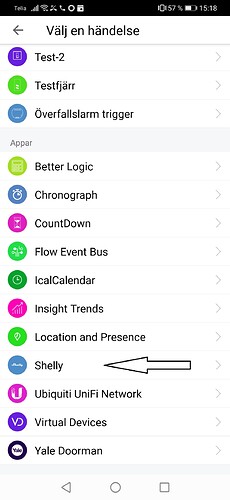

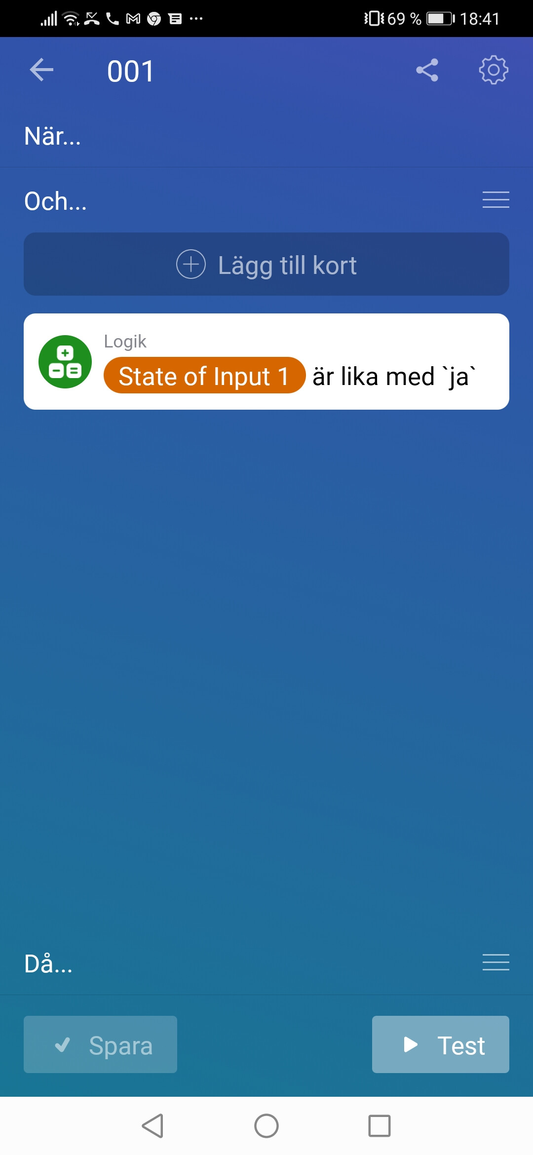

I nearly start to feel stupid. I can not get it to work. Where do I go wrong,
My setup in the flow is this.
ja mean Yes
When I found the Shelly in the Logic the status is No
And I have disabled CoAP.

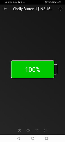

I can even see the status of the batteri, which I can not see if CoAP is enabled.
Regards
/Anders

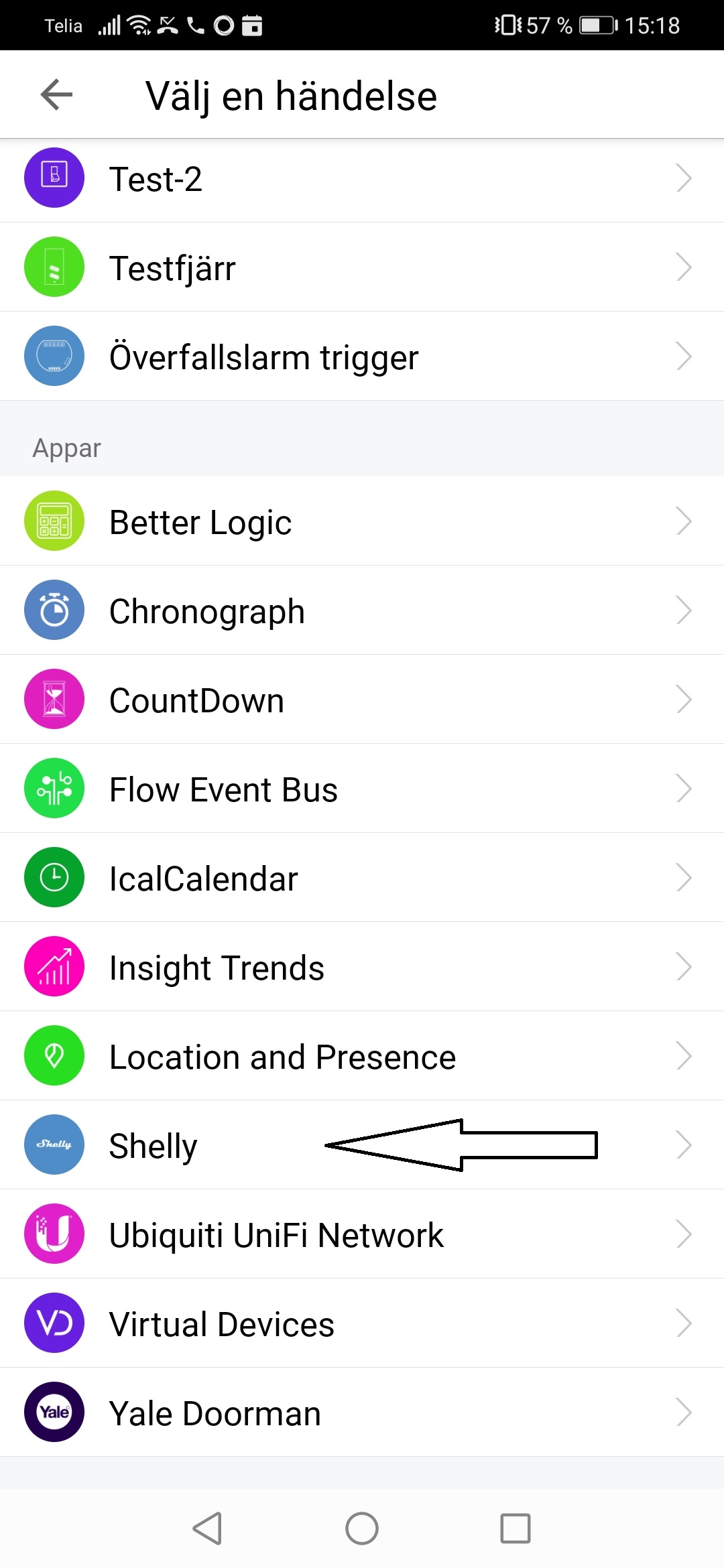

The trigger card you are using is not from my app. I have no idea what it does and can’t guarantee it works. Use the action events trigger card from my app as described in the instructions or the input state has changed device trigger card from the Shelly 1 button.
But if the battery state of the device is not updated even though it has changed in the official Shelly app it means your network is not configured correctly for the use of CoAP, see the CoAP troubleshooting guide. Action events like shortpush don’t work when CoAP is not working or has been disabled. These battery operated device don’t work well with http polling either as they are asleep most of the time.
If you can’t get CoAP to work in your network, you will have to wait a week or two until there is a new firmware for the Shelly which brings unicast support. This avoids network issues.
I really have to apologize. I completely missed your special app (see attached) for managing the flow. You must be wondering if I really knew what I was doing. Have not seen this solution before so that is the explanation. As you say, I need to wait for the next firmware for my Button 1 because I do not get SoAP to work in my network. Again I apologize.
