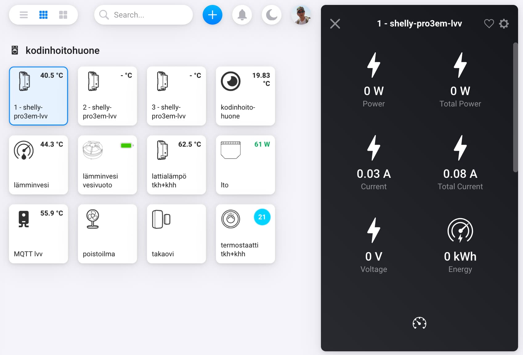

Seems that pairing Shelly Pro3EM with the Switch Add-on does not detect the switch on the device.
There is no control for the add-on relay with the first Pro3em device not the other two.
Doing an api call to http://192.168.4.31/rpc/ProOutputAddon.GetPeripherals
Reveals the add-on {"digital_out":{"switch:100":{}}}
And calling http://192.168.4.31/rpc/Switch.Set?id=100&on=false works as expected.
Currently Shelly documents that the add-on is only available for Pro 3EM at this time.
These seem to be two different devices seeing the IP addresses. One indicating networking issues and one indicating outdated firmware (although this could also be network related). Follow the troubleshooting guide to the letter (for instance, did you enable cloud before checking the firmware).
Submit a feature request on Github. Donât think I implemented this already.
