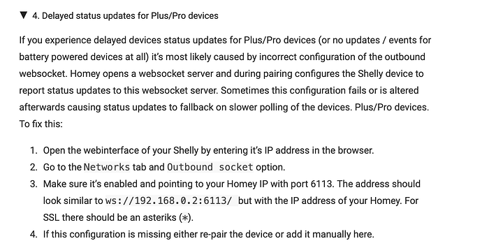

I made this, still have a white screen. Shelly firmware 1.0.0-beta2, Cloud is on, Password auth is off, mDNS discovery works, Outbound Socket ready with ws://192.168.1.3:6113 with different TLS (screenshot below), router MikroTik. What problem can be?
There is a trailing slash missing in the server for the outbound websockets. But you should not have to edit this field by hand. Upon pairing the device the app will configure this field for you. If pairing is giving issues there probably is something wrong within your network. Restart the app, wait 1 minute, try to pair the device again and send me a diagnostic report afterwards so I can confirm it’s networking issues.
