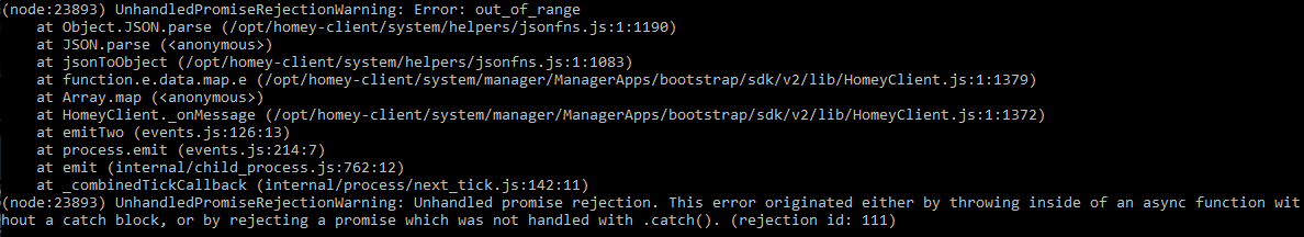

@Phuturist Maybe this is more convenient:
Weird, do you have any other Shelly devices already paired. Iβm not even sure this error is related to the Shelly 2.5.
Yes, a shelly 2. And it still works.
Also the power measure in the device card?
yep
And something else, could you check if the Shelly 2.5 devices have not been added anyway even though there was no confirmation. It could be the devices where actually added.
No, the shelly2.5 is not added. (shelly2 was installed several months ago)
Iβm clueless, not sure how to proceed.
I need to know if th is error comes from the new Shelly 2.5 driver. It appears to come from your Shelly 2 device.
Could you run the version 1.6.0 from the command line and let me know if the error is also there.
