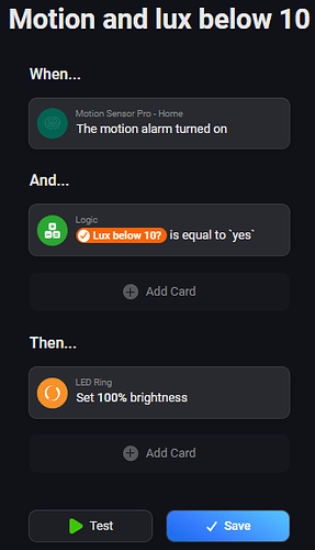

I got the MOSZB-140 Motion Sensor Pro.
I want to make an flow.
When there’s motion and lux lvl is below 10 then light on.
But I can create it because AND there’s no lux function.
Hi.
Please do as follows:
  1. Create a Yes/No variable, and call it for example “Lux level below 10?”.
  2. Create these flows:
The LED ring is an example of the light here.
There is an easier (single) flow solution (without the use of a variable), using a logic card and the luminance tag from the motion sensor.
When: The motion alarm turned on
And: Logic card, Number is less than Number. In the first Number, select the # luminance tag from the motion sensor and add the level 10 to the second number (comparator)
This approach you can use also for other numeric capabilities.
Then: execute your action.

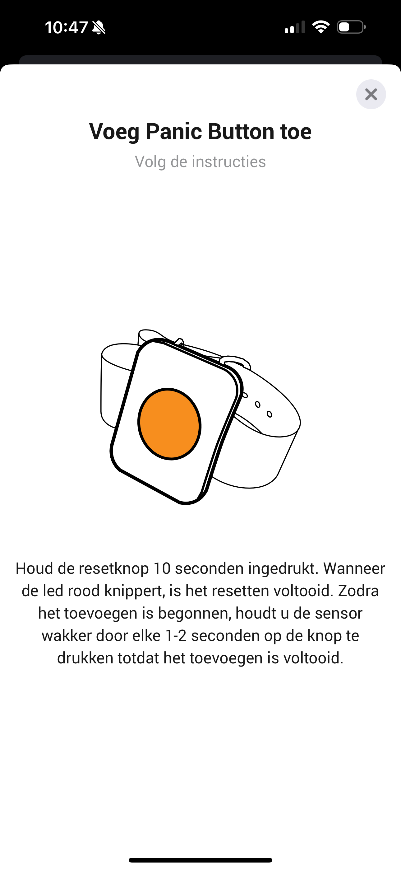

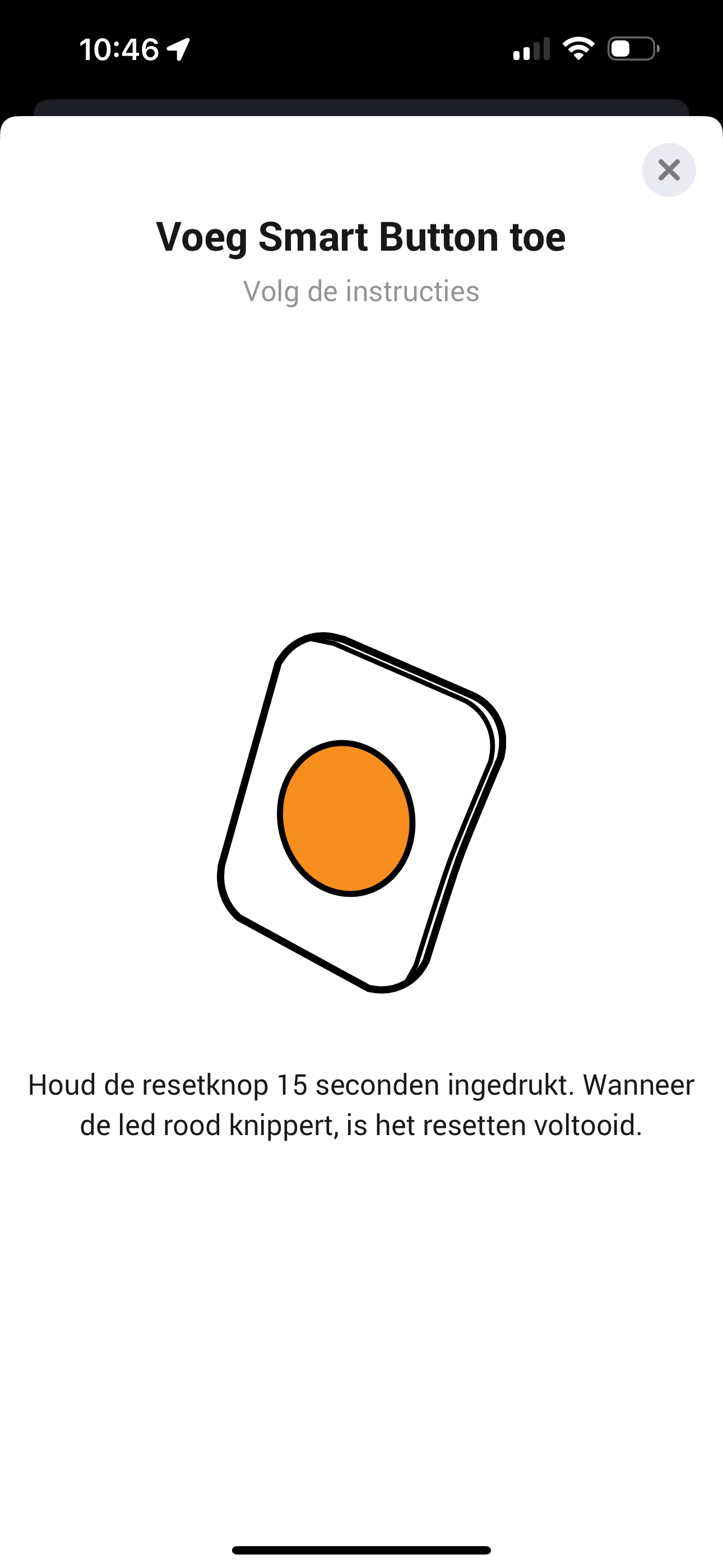

Hi all,
I’m having difficulties adding the frient Smart Button to Homey.
(sorry, screenshots below are in Dutch)
I’ve done the reset described here many many times to no avail.
Then it seems like it’s finding the sensor, but this always takes a good while.
Then eventually trying to add the button ends with this message every time.
I’ve tried literally everything I can think of: restarting homey, unplugging homey for a while, doing the “download full software update” reset thingy, unplugging the battery of the sensor, removing and adding other devices, …
But I just cannot get this Smart Button to join my Zigbee network.
Not sure if any of this matters but:
  • I’m on Homey pro 2019 (the white ball).
  • I have 3 other frient devices that were added very easily and work perfectly (2 smoke detectors and a door sensor).
  • I know I’m past the theoretical limit of Zigbee devices for my Homey (currently at 65 without the button). But I’ve had almost no Zigbee problems ever, the network here is super stable, other brands (I tested Aqara and Ikea specifically) are still joinable without a hitch and I have a good amount of routers.
  • I thought I bought the smart button, and the packaging also says “Smart Button”, but weirdly on the back the model number seems to indicate it’s the panic button (PBTZB-110 instead of the expected SBTZB-110):
  • Because of the above I also tried adding this sensor as a Panic Button. There the instructions for adding seem wildly different, but the process fails in exactly the same way (taking a good while for adding and then saying the device couldn’t be added).
  • I’ve also tried following the instructions in the manual of the Smart Button to the letter, but no help.
Somebody who sees what I’m missing?
Ideas for anything else I could try?
Thanks for the help!
