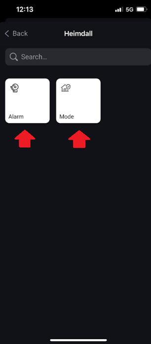

Now, add a new device by clicking on the plus symbol, select Heimdall as a manufacturer, and add both – “Alarm” and “Mode” components.
When done, you will see the “Surveillance” object in your Homey dashboard. This is a control panel for your Heimdall system.
Changing the modes there will cause the mode to change on your Intelligent Keypad, and vice versa (with a valid PIN code and/or RFID tag).

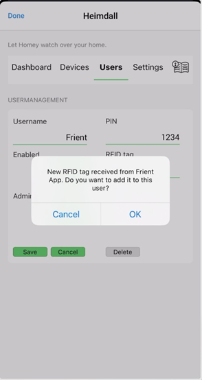

Assigning RFID tags to each user
To assign an RFID tag for a specific user, you don’t have to manually type in the number.
Instead, you can follow this guide:
  1. From your Homey devices overview, select Intelligent Keypad, click on the gear icon in the top right corner, and select “Maintenance”:
  2. In here, simply click on “Add RFID tag” button:
  3. Apply the desired RFID tag onto the surface in the middle of your device, and when you hear a beep click on the “Arm all” button, as shown below:
  4. Now head back to your Heimdall app settings, go to “Users”, select the user you wish the RFID tag to be assigned to, and you should see the following pop-up window – click “Ok”:
  5. The RFID tag has been successfully assigned to the selected user:

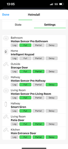

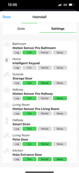

Setting up devices within alarm modes
With the Heimdall app and frient devices, you can easily select in which alarm modes the devices will trigger an alarm.
To do that, simply go to your Heimdall app settings, go to “Devices”, and select “Settings”.
Here you can customize each device and its role in your system:
“Log” – you can use it to collect readings from the sensor which later you can see in your Heimdall dashboard overview.
“Full” – stands for assigning the sensor to an “Armed” mode.
“Partial” – you use for assigning the sensor to trigger in a “Partially armed” mode.
“Delay” – adds additional delay which you can customize in Heimdall’s main app settings before the sensor triggers the alarm.

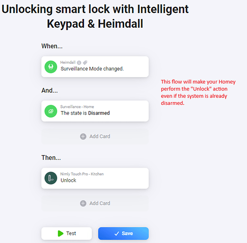

Unlocking smart lock with Intelligent Keypad & Heimdall
Important note:
Even if the mode is already “Disarmed”, disarming it again will result in the same action you choose (e.g. door unlock).

In which mode should the keypad be? Log/full, none?
