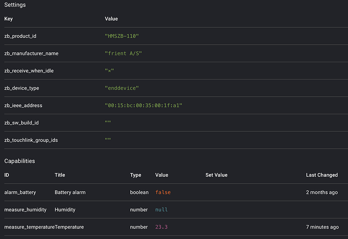

Still having issue with HMSZB-110 not reporting huminidity… i have 3 of them, and none of these report huminidity, not sure what to do to make them report (repaired several times, still no change)…
Please don’t use repair. Instead, delete the device from Homey entirely, factory reset it (hold the button until the LED flashes multiple times in a row), and add again, just as the first time.
Removed, included, same result
That’s really strange.
I’m running multiple different frient humidity sensors (both HMSZB-110 and HMSZB-120) on my Homey 2019 and Homey 2023 with the latest frient app, and there are no issues on any of them.
Try one more thing - delete the device once again → restart the frient app in settings → factory reset the device → add it again.
Still same result, even restarting homey did not help… i guess i will just have to get used no huminidity atm…
I’m sorry to hear that.
Would you mind trying to reset your Zigbee network, and/or uninstalling and installing our frient app?
Just note that resetting the Zigbee network will erase all devices you have on your Homey.
Uninstalling the frient app will obviously erase only frient devices.
