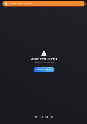

Anyone else having trouble with chargemps halo after homey update 13.5.1? Mine is not connected, unable to repair, refuses credentials.
Not with my Aura charger, it’s connected via LAN.
I am also using Lan. The charger is online, working fine using its own app but in homey I encountered this problem. Restarted homey and the app.
update:
I have also removed the charge amps app and tried to add the charger again. I can login on charge amps admin page, nothing wrong with my credentials. Could it be my api that expierd? Refues to take any credentials:-(
It was my api that expired.
