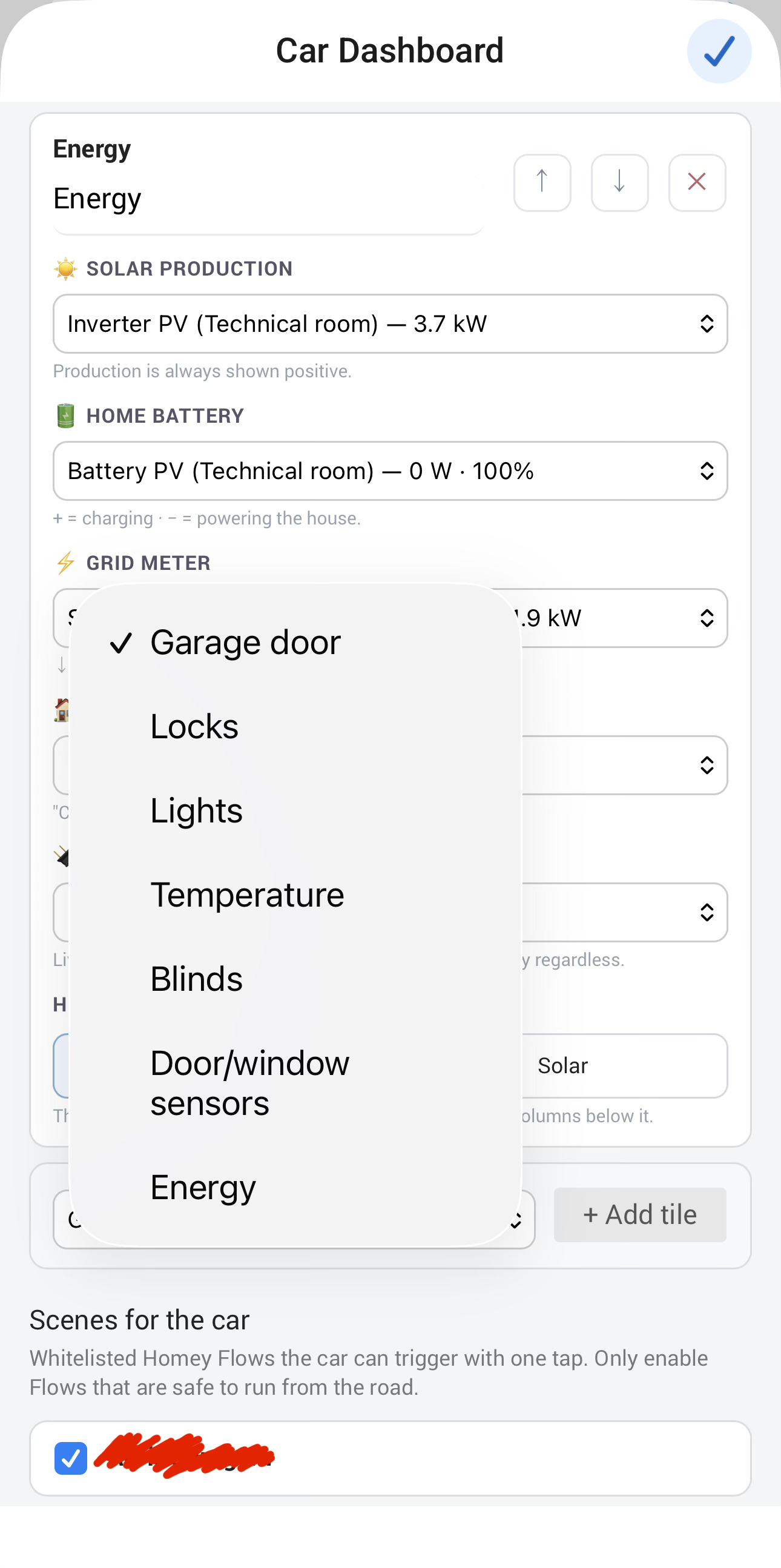

What it does
The main screen is a grid of big tiles. You pick them in Homey: garage door, gate, front door lock, alarm, the EV charger, whatever makes sense for you. They show the current state and one tap toggles them.
There’s a lights tab with your lights grouped by room, on/off per light or the whole room, and a proper level screen for dimmers with steppers and presets. No sliders, Google doesn’t allow them while driving.
A scenes tab shows the Flows you’ve picked as buttons.
The part I’m most pleased with is the garage warning. The car keeps a geofence around your home (coordinates come from your Homey’s own location setting). If I drive off and the garage is still open, a notification appears in the car with a Close button. When I come back and it’s closed, I get an Open button. Pressing the button just does the action and the app doesn’t even have to be open. Been running on my car every day since mid-summer and it has been reliable, including with the car off overnight and after Play Store updates. You can leave this off if you don’t want the car using location.
Setting up
Everything is a whitelist. In the Homey app settings you tick the devices you want as tiles, tick the lights, tick the Flows, and drag the rooms into the order you like. Nothing else is visible to the car.
Pairing works with a code: generate one in Homey, type it in the car. The code is good for five minutes, and it locks after eight wrong tries. Every paired car gets its own token, and you can see them all in a small list in the settings with the car model, software version, last seen time, and buttons to rename or revoke. Handy if you have two cars or two driver profiles for the same car.
