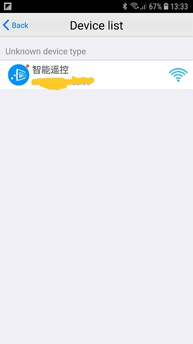

How can I recognize the “red” bean? The physical color is black. I can’t find neither of the codes you mention. Bottom shows FCC ID: 2ACDZ RMMINI3-RM.
It’s like the new red bean version instead of the black bean version.
The Red has device code 5f36, the black has 2737.
And because this Broadlink app uses the E-control app (where u cannot add the device) it’s for now not possible to add it to Homey and get it to do something.
I added two black ones Yesterday, using the old e-control app on IOS to add the Wifi config and than added them to Homey. They came with Fw. Version 5.0
Black versions have no problems to connect indeed, it’s the “Red” versions giving trouble.
How can I recognize the “red or black" bean? The physical color is black. I can’t find neither of the codes you mention. Bottom shows FCC ID: 2ACDZ RMMINI3-RM.
Bottom shows the same here on 2 different devices. For what i know: The red cannot be added to the e-control app and shows an error in the Homey app with the (5f36) code. The physical color gives no guarantee although there are actually also red colors.
Ah you are right, I received this code in the app as you mention (also visible in my screenshot).
Thanks for the quick help\responses.
Anytime!

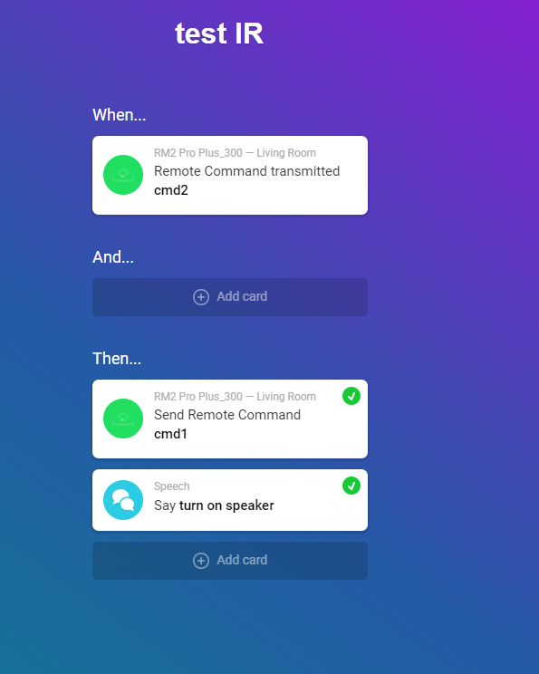

Hi, i have RM pro plus. I succesful lear RF key or IR I set flow, that i push button on RF or IR (set in flow) remote, nothing will happen. Sending learn signal in end of flow works perfect, but start flow via signal NO :frowning: Where is a problem. Thx
