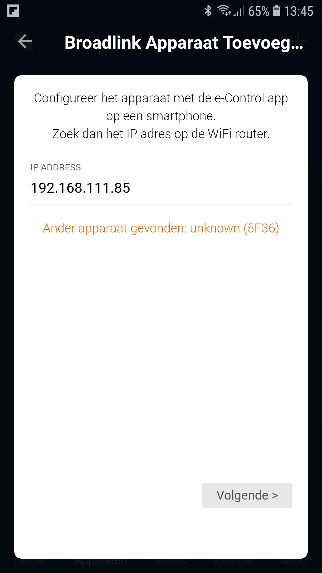

Unfortunately I am not able to get the app to recognize my rm mini 3. Please help.
Background
I bought the rm mini 3 because I was not able to get the IR sufficient working on my homey.
When I add the device via the app it feeds back that the device is unknown.
What I tried so far:
  • Used the setting “eenheidsmode”. This resulted into adding the RM but I was not able to learn any controls.
  • In the econtrol app from broadlink the device is also not recognized. Therefore not able to add any remotes.
  • The broadlink app does recognize my rm mini, and I can add devices and scenes. It works fine.
  • The ihc app recognizes my rm mini 3 as well, can add devices and scenes. I was able.to use this account to link more or less ok with Google home. Other accounts do not work
