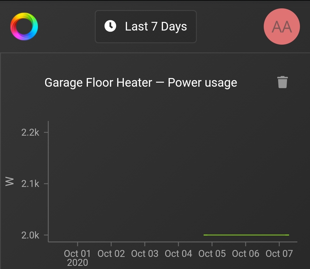

Should energy measurement show right with thermostats? Now only shows the setpoint.
