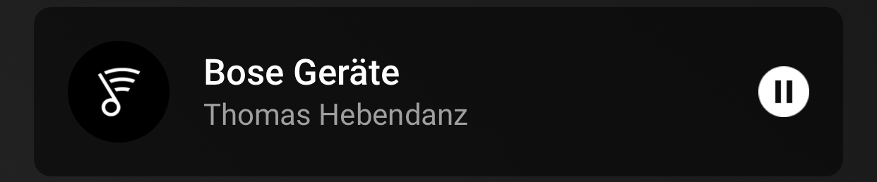

Yesterday the App becomes paused. And all devices are unavailable. Any Idea why it happens?
@Osorkon
Wow. Now that’s a steep memory peek. I don’t even know where this could possibly happen in the code. Can you please send a diagnostic report from the app menu when this happens. Also please mention your forum name if I need to get back to you with questions.
For the paused state. This can happen if the app misbehaves, as in taking too much RAM in short time or consuming too much CPU power.
@Osorkon
Should rather look more like this: image
