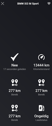

Is this app dead? Not a single function seems to be working.

The app still works on my Homey…
And does function lock/unlock/climate works for you? Because these functions do not work for me…
No, stoped working long time ago.
That’s what I am talking about. The only two functions that are handy for automation and it doesn’t work. And developer seems to be dead to fix the issue. This is a real weakness of Homey :sob:
