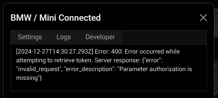

just a follow up question/update; it appears to work after having added the Captcha for an hour or so and then it stops sending/receiving updates. Adding the Captcha again resolves it but only for another hour. Has anyone else had the same? I did not remove and re-add my car when I downloaded the Test version, would that be a possible cause for this behavior or…?

Whats your polling interval? Also there is now a developer tab in rhe settings. You can try to clean the token and try once more.
300 seconds polling time. It works well for about 60 minutes, after which it stops updating.
I’ve cleared the token and did another “save” on the settings with a new Captcha token. Keeping you posted :slight_smile:.
Fyi, I test it by both Polling data from the car and Sending an action (blow horn in my case). This works well just after I’ve saved the settings again up until an hour from that moment in which the actions don’t work any longer.
I can confirm that the same behavior occurs. After an hour polling/ pushing actions do not work anymore.

With update 0.6.1 the login works, thanks for that.
When I want to add my vehicle I get the message that no new device was found, anyone an idea how I can add my BMW
Still the same with me as well. Login works again, but doesn’t “see” the BMW when trying to add.
I’ve the same problem. :cry:
Yes I have the same Problem. I can’t add my vehicle.

I was able to login and add my car. But I don’t get updated values from the car. Like battery and milage. It got the values initially. I can’t lock unlock. So it seems like I doesn’t work very well.
I’ve got exactly same issue. Car is recognised. Initial values are displayed, but no updates since then.
Did you update the polling interval to at least 5min as suggested by the developer?
