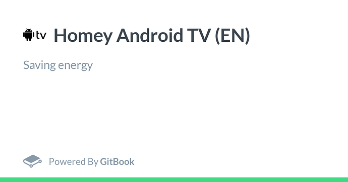

Hey everyone,
I’m thrilled to tell you about what inspired the Android TV app. At first, I planned to make a post, but then I realized it might be even better to show you a real example of what the app can do. So, here’s a lively use case that really brings it to life.
(Please note that I haven’t added the English flow examples yet).
Feel free to share any thoughts or suggestions you have. Let’s keep refining this app together!
Cheers!
Nice! But… Standby of tv’s is 50 to 100 watt??? That’s really not true…
A modern tv only consumes 0,5 watt in standby… There is even a European law that says that a TV may not use a lot more than that.
So, the example is nice, but the data is not correct.
That might be true for newer TV’s but my old Philips TV has a massive power consumption when in standby ![]()
I’ll look into updating the example to reflect newer TV’s though, Thanks for the feedback!
The younger gen probably don’t use devices older than 3 years ![]()
