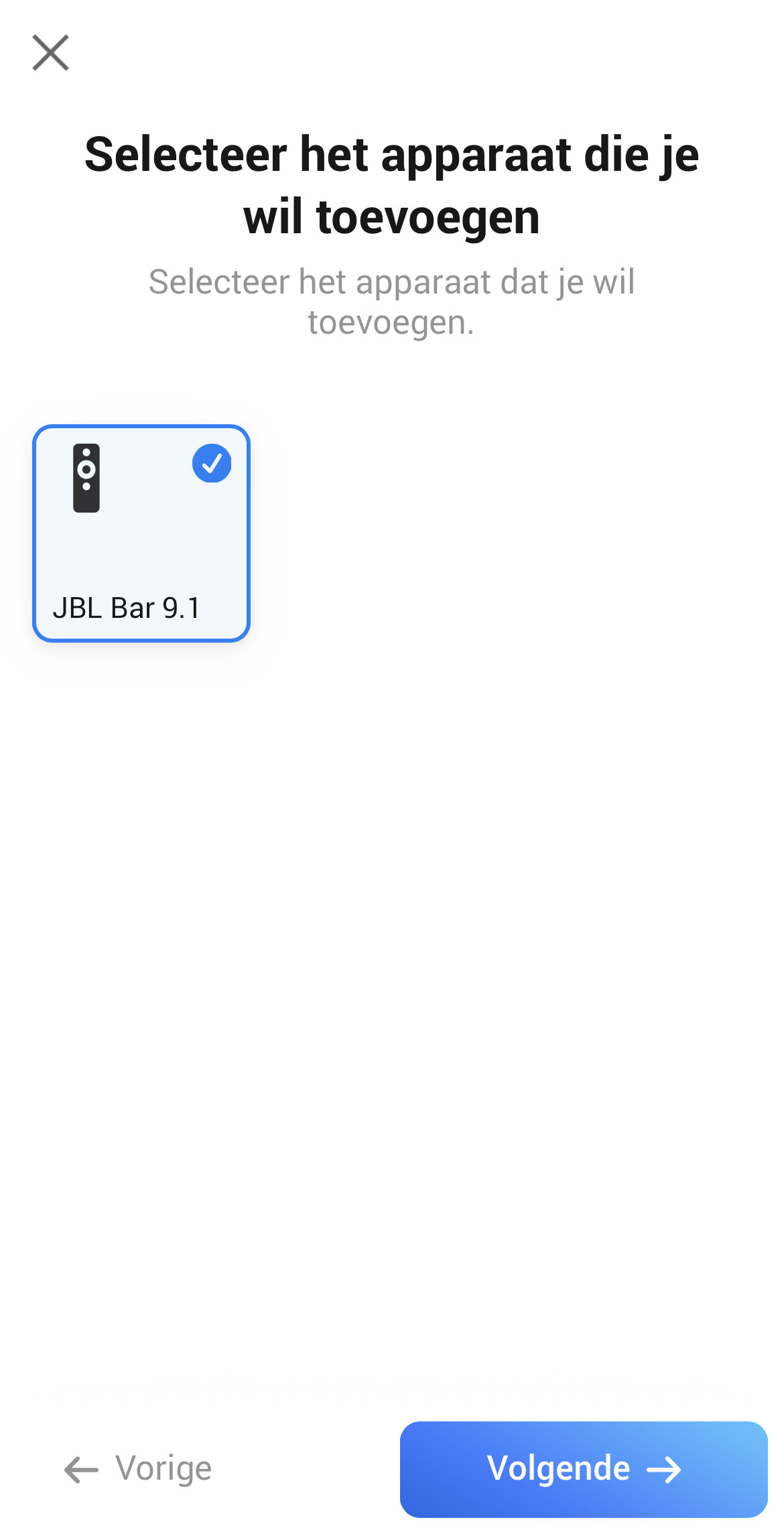

Apparently it is possible to add a soundbar - in this case a JBL BAR 9.1 - into Homey (Finally)
This bar doesnt have a screenmode. is there perhaps a (standard)code for that to add??

Jbl bar 9.1 has chromecast/airplay.
