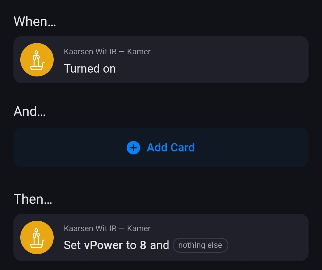

I’m analyzing the possibilities of AVD, and I admit it’s a fantastic tool. However, I think my knowledge isn’t sufficient to achieve what I’m looking for. I want to create an AVD that will be the equivalent of a light bulb—it should turn on and off like a real bulb, and I’ve managed to do that. However, I can’t figure out how to set the virtual power consumption of this bulb so I can use these values ​​later.
Hi Damian,
If I get what you say, you can add virtual power usage by adding a numberfield like this:
Set the power to a virtual number of Watts when the virtual light is turned on, and set it to 0 Watts when turned off:
