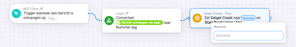

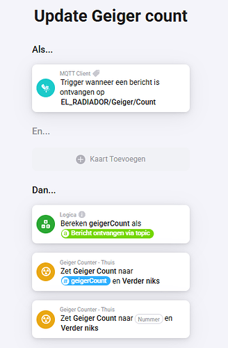

However, I found a small difference between Web and App:
I want to use a textual value I get from MQTT, to set the numerical value of an advanced virtual device:
The first “Set Geiger Count to #geigerCount” is made on mobile. No complaints there, works as specified.

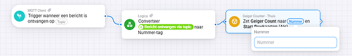

However, when trying to recreate such a card on web (which I did on the second "Set Geiger Count), it doesn’t allow me to set the number to a variable or use a tag:
I could use the app for this, but I really want to use the web flows because of possibility for advanced flows, that has the same issue:
Am I doing something wrong, or what’s going on? :smiley:
Euhm, no, as far as i can see, ypu are not doing anything wrong. Its a number field, so tou should be able to use tags. Perhaps the webapp has a (new) bug in it?
Anyone knows?
