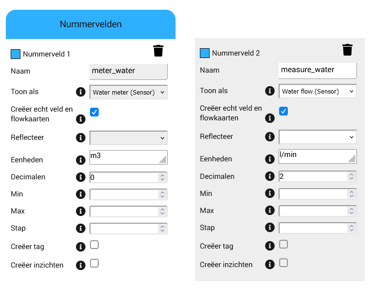

Okay, I wasn’t aware of that.
‘Cumilative’ seems not possible for meter_water and measure_water?
(In reply to @Peter_Kawa in this topic where it belongs…)
I am still looking for a solution to get our water visible in the energy dashboard…
I guess it should be added to the app probably:
The app should offer a device setting to define cumulative yes/no similar to this:
Device settings:
io.home-assistant.community/drivers/custom/driver.settings.compose.json at main · RonnyWinkler/io.home-assistant.community · GitHub
Then set the device energy object like this:
io.home-assistant.community/drivers/basedevice.js at main · RonnyWinkler/io.home-assistant.community · GitHub
The device can be configured in standard device settings then:
But Arie could also add this to the repair view But I think device settings is more intuitive because the “include in total” will show up there, too.
