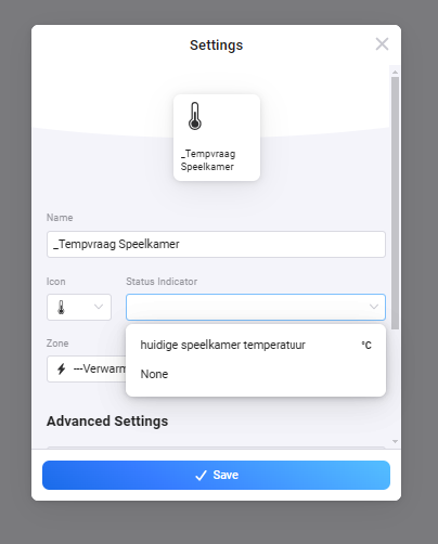

Hi guys, sorry just getting started with the advanced virtual devices. i think I would like to do something simple, but it’s not working. I would like to have an advanced virtual device that shows the state of my blinds (open or closed) on the tile without opening the device (for use on my dashboard)… When I add a textfield in the repair settings pop-up, I can use it in a flow to set the text to open or closed, but it’s not showing up on the tile. When I use the “status inducator field” - I can’t update the text on the tile so it seems…
Can you point me in the right direction please?
After creating it all, did you select the text field as status indicator in the Homey Mobile App?

To reflect the variable in the icon tile you have to: Change the status indicator…

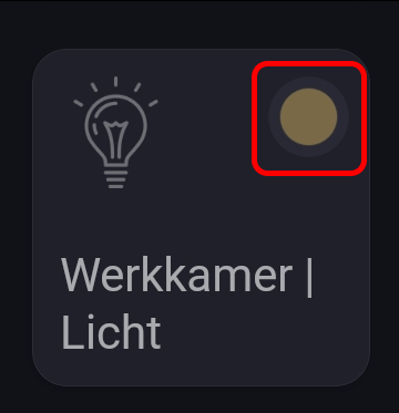

I have one question: I’ve created a virtual device for use with a Homey dashboard, and I’ve selected the device class ‘light’. So my button has this nice yellow indicator on it.
Is there a way to turn this on and off as well? I can’t seem to find the correct property to do so.
Thanks!
CJ
Hi CJ,
You’ll have to add an OnOff capability to make it switchable.
It’s key to use “Button 1” for that:

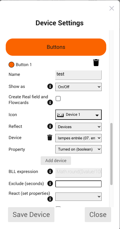

    At the very top of this thread Arie should how to create a 4 curtain button. I tried to replicate what he does, but it’s not triggering any of my curtains, which seems logical as the buttons are not linked to any device, or maybe I missed the point
I have just tried to replicate the example provided by CJ Scholten and the advice of Peter, but it’s not actually controlling my device (a lamp) just miroring the status of the device (if I switch lamp on from original device it shows it on in Device Capability)
Here is my setup, maybe I’m missing something
Thanks
