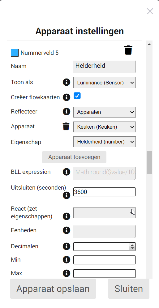

I also combined two lux sensors and when one is offline, the AVD continues to calculate the mean between the old value of the offline sensor and the current value of the online sensor. I want the old value (or the offline sensor) to be ignored.
Can you please share what BLL you used or how to set the AVD?
This is great indeed. I have most of the options working for all my avd’s with lights and sensors in them.
The only thing that not seems te be working correctly is the timer. Tested on my kitchen sensor and the timer goes directly to 49 seconds (Not visible in this image) and stays on that number. Not sure if I did something wrong here?
I also miss a few options that are set in the examples like “Berekening” and “Debounce”.
Why is that?

With these settings, it works:
I discovered it does not work when “Create Flow Cards” isn’t ticked. (Which is odd to me, while you don’t need a flow for this to be functioning. Is this a bug or need-to-know @Arie_J_Godschalk ? Thanx m8)
