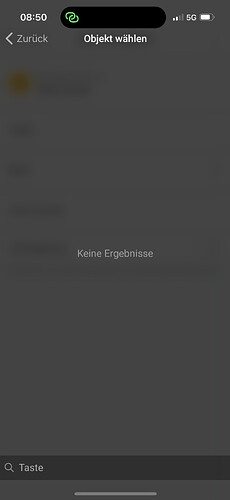

Sorry I don’t get it, I’m selecting in the flow “than” my AVD Device → Taste setzen. There I can’t select any “Taste”, the menu is empty. And as value there is only “Ja/Nein”… no option to select the picker or a value.

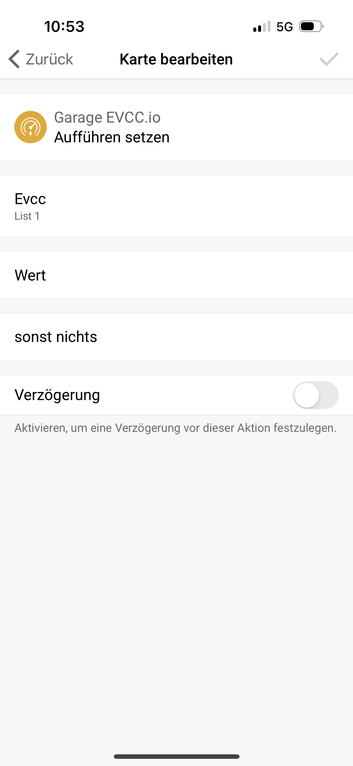

Tried „Aufführen setzen“ as well. I can select my list, but the values there are always empty. I can‘t select a value…?

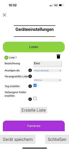

Please show a print-screen/screenshot of the List settings from the AVD?
He we go
This should be the value, but it is empty
Perhaps, once, remove the (name of the ) List and press save, then recreate the List with the current settings (they are correct, but perhaps it created a device wrongly during the change).
I have the same configuration as you, and i do get a list of values to pick from in the same card.

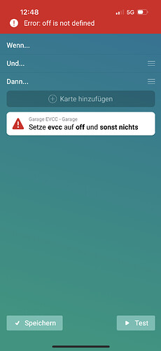

And „Bezeichnung setzen“ doesn‘t work either. There must be an issue somewhere…

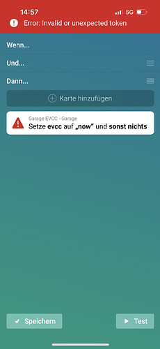

Here you need to return it as string/text, so, place the off between 2 double-qoutes.
Still no luck :weary:
Those are not normal double qoutes.
