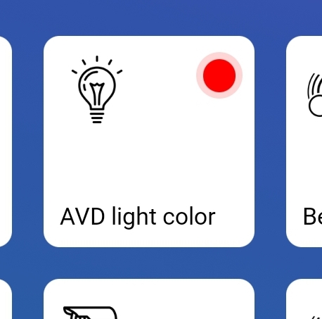

One other thing I’m trying to figure out is why the color of the tile doesn’t change to right color when the colors of the bulbs are changed in onother app than Homey.
For example, when I change my bulbs in the avd to green and set it to red in the hue app the tile stays green but the lights do become red.
Any idea how I get the tile to change to the right color no matter from where it will be changed?
Thanks.

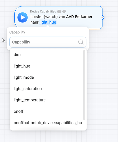

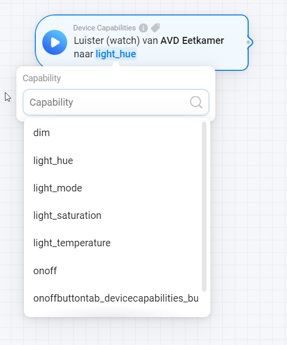

Does the bulb-device has a trigger/when-card for when it’s color changed?
@Heula
The DC App also has a Watch/Listener when-card.
Use that one, select the device, and then check if there is a color Capability?
(I don’t have Hue, so i don’t know which capabilities they have.)
