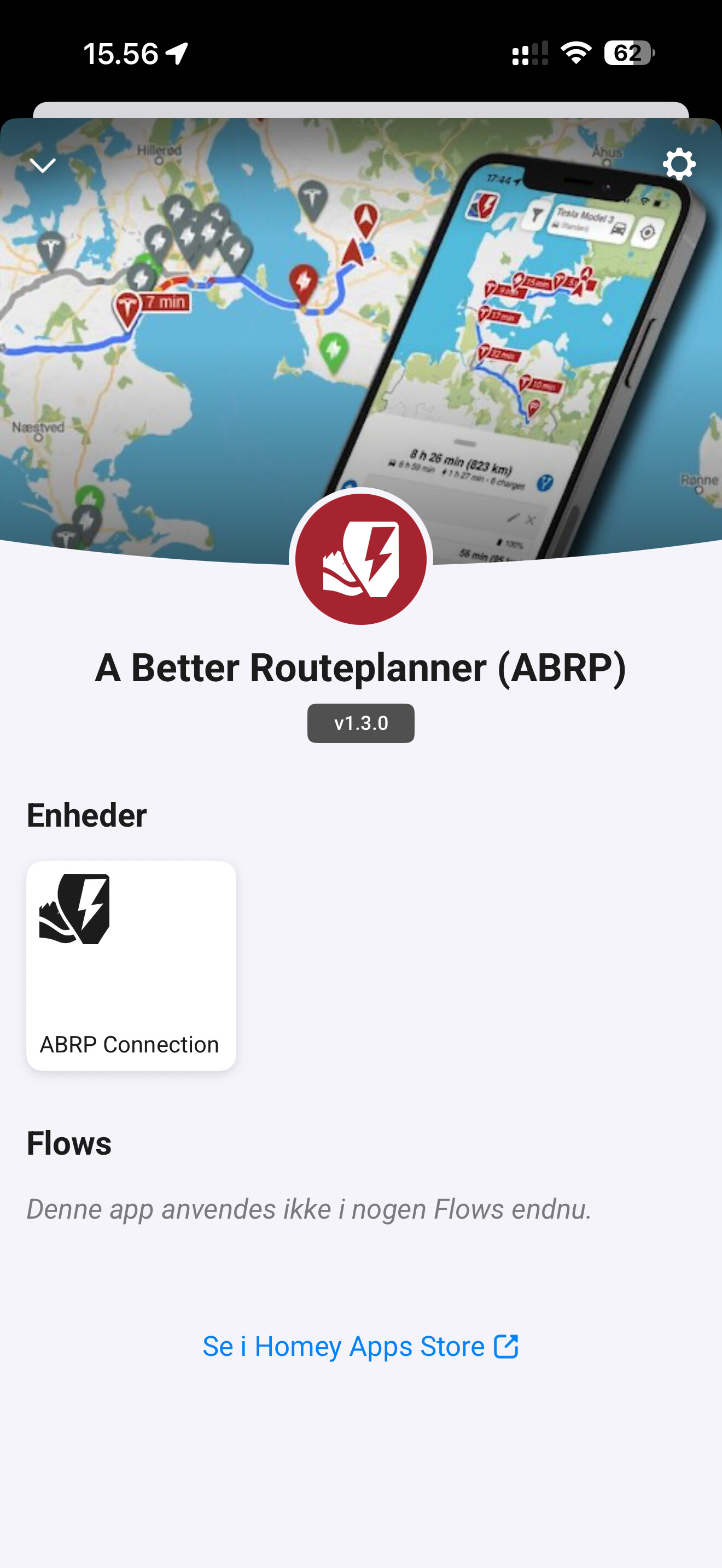

I just try to link my car with ABRP now I have to unknown car in ABRP I can not get them to go away how do I unlink homey or the app in homey from them
@Morten_Christensen Sorry this is not really clear, can you explain?
I have to unkowing vehicle in ABRP after I linke the app form homey I like to get Them out of ABRP again because it screw up my connect with my watch I can not delete them in the ABRP app. So I must unlink some how from homey I think
@Morten_Christensen no homey only makes a connection, so if you want to remove a car you should do it via the ABRP app (https://www.iternio.com/faq)
Hi I can not delete or remove them after I connect with ABRP from home I don’t what it to be connected I try to remove the app from homey but the unknown cars are still there . I do t know how to unlink homey with ABRP that must bee the problem
@Morten_Christensen that’s not the case homey only links to ABRP.
So you can uninstall from Homey but that won’t change a thing. You have to remove the car inside ABRP as I already mentioned
Ok thanks then it is a ABRP problem I can not select it. I white box comes up so I will contact ABRP sorry for troubling you
@Morten_Christensen maybe it works when you open ABRP on web
