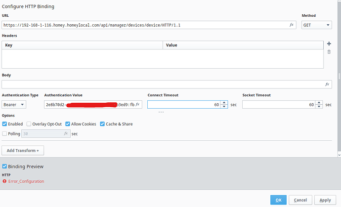

So, I guess the URL should then be:
https://192-168-1-116.homey.homeylocal.com/api/manager/devices/device/ HTTP/1.1
But, that returns “null”. I’ve also tried that from ignition. Which also returns an error… Do i need to use headers? If so, what should they be?
For implementation details I have to read the manuals. It looks like you should do too. Maybe you can find an example somewhere.
