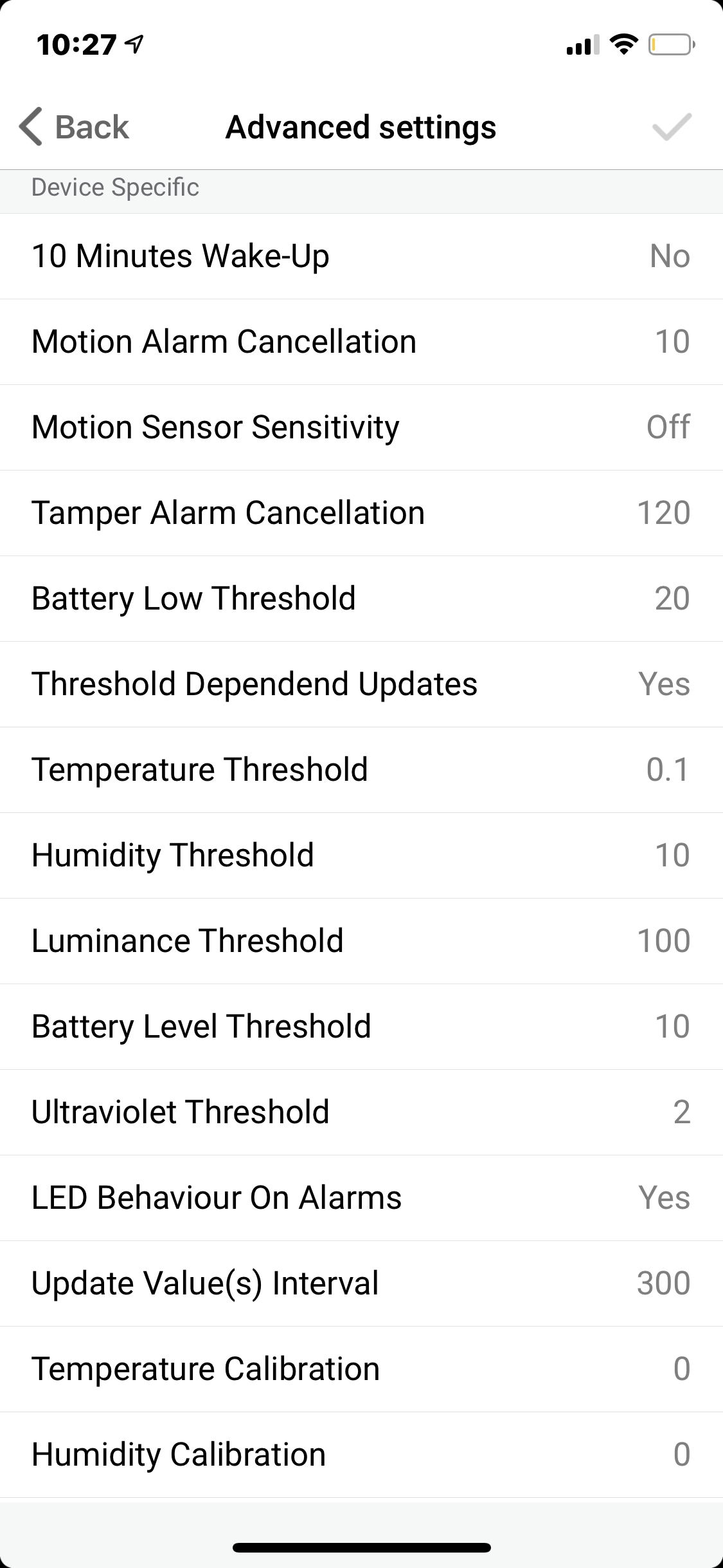

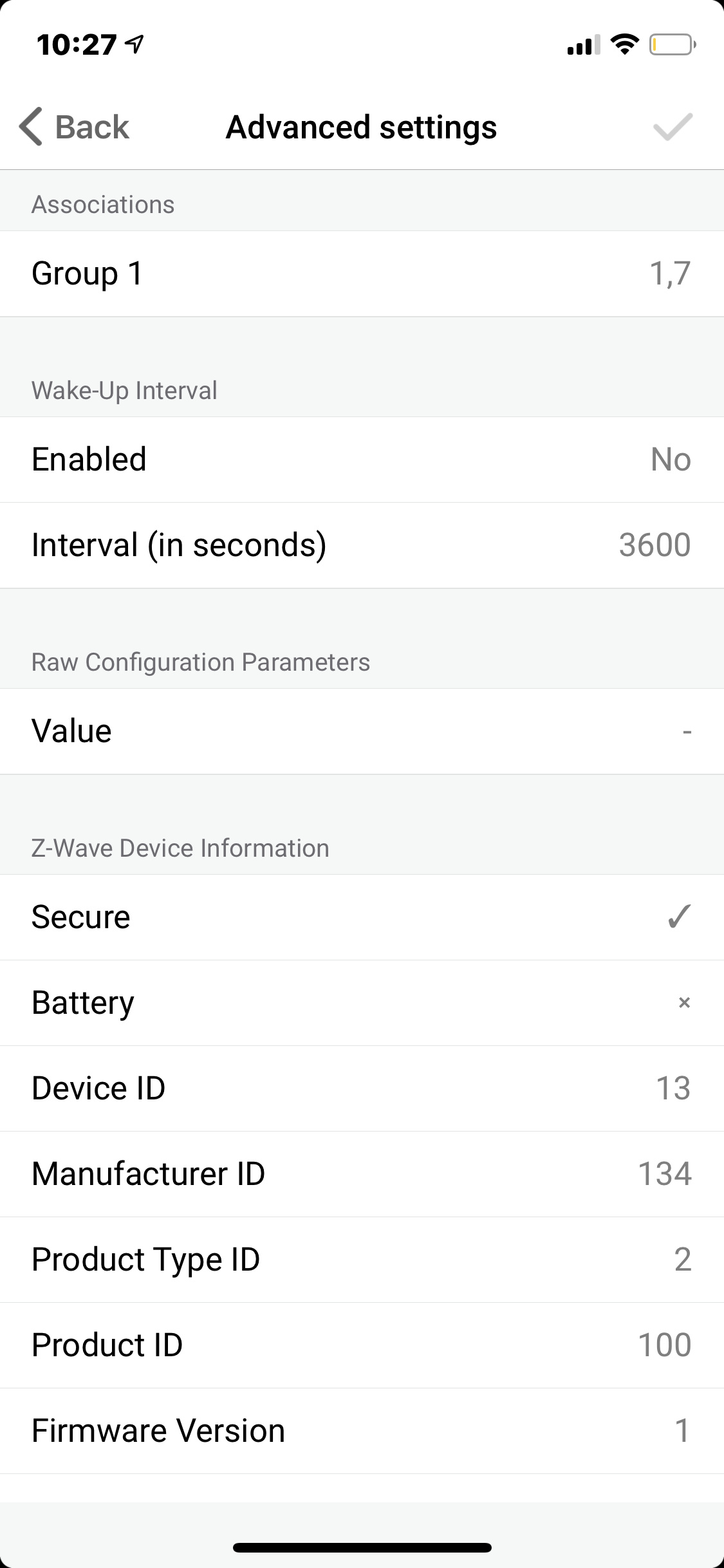

As the radiator is sitting under the window ledge it’s temperature sensing is definitely off as heat tends to accumulate there. So I am using one of my Aeotec MultiSensor to get the temperature and regulate the Spirit valve but it seems like the spirit just keeps heating at 100% no matter what I do. As soon as I tell the spirit to stop using external temperature readings it closes the valve as it reads 25degrees and the set temperature is at 19.
So I am wondering if I did something wrong with the association and it is actually not getting any temperature information?
As I understand correctly just the value sending device needs to be associated?
EDIT:
AEOTEC Multisensor was included with USB Power and is USB powered.
Spirit Valve Settings:
Aeotec Multisensor Settings:
