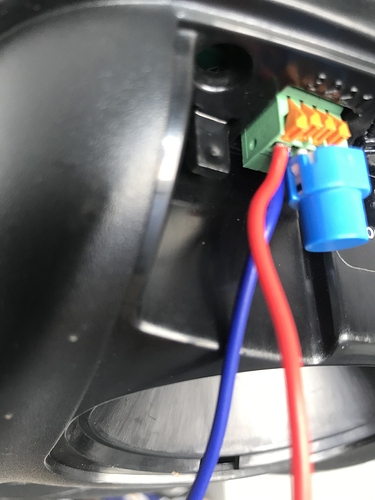

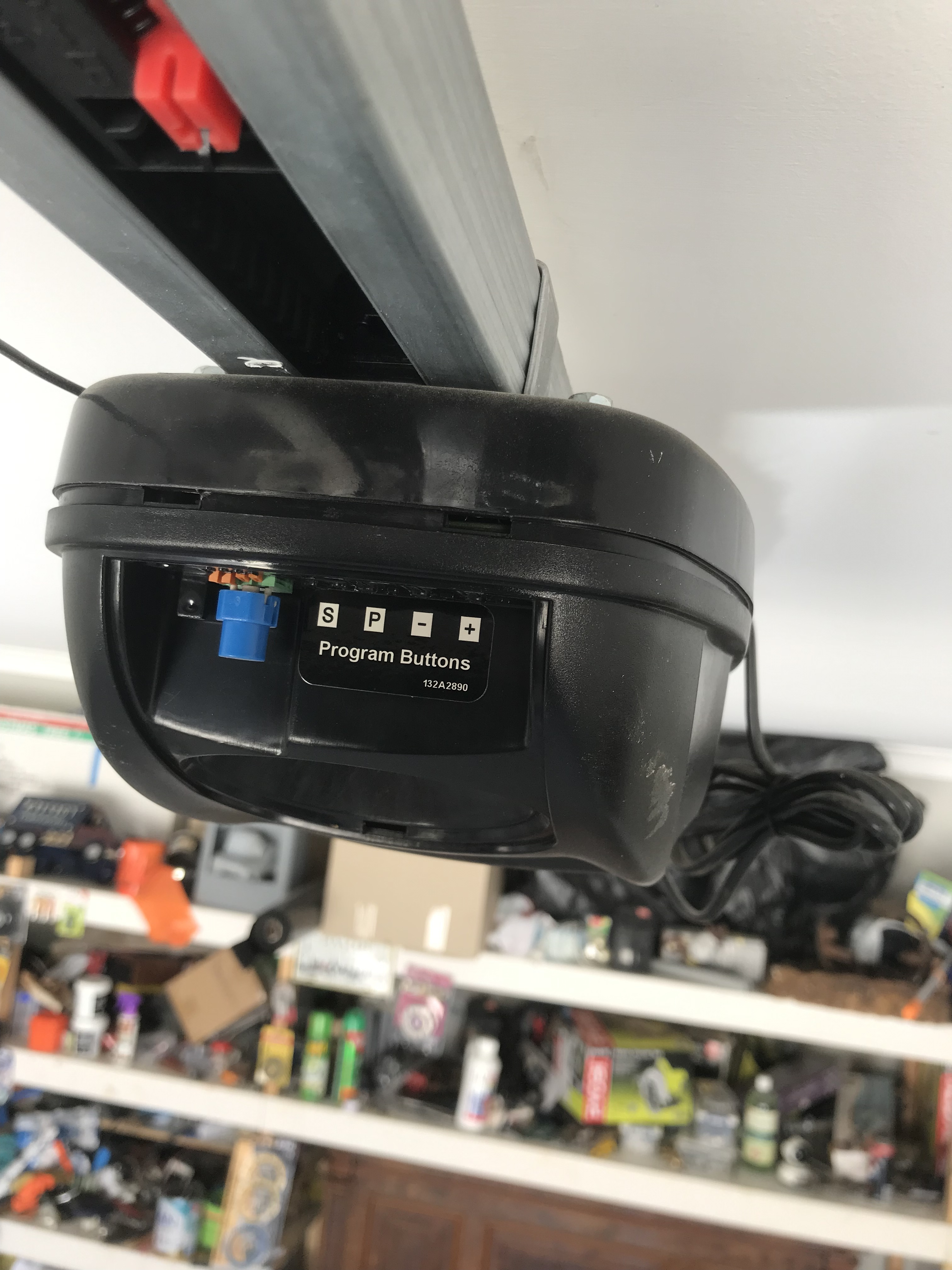

Here is a couple of photos of the motor controller on the roof. So is this what I connect to Jamie, and how exactly do I connect it?

So do you think I need to piggyback it to the red and green wires? They seen to be the only ones going to the motor. Oh but there is a white one too.

Is there no text on the board next to the green 2-pole connector? Possible this is a connector for a push button?

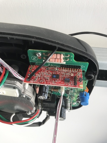

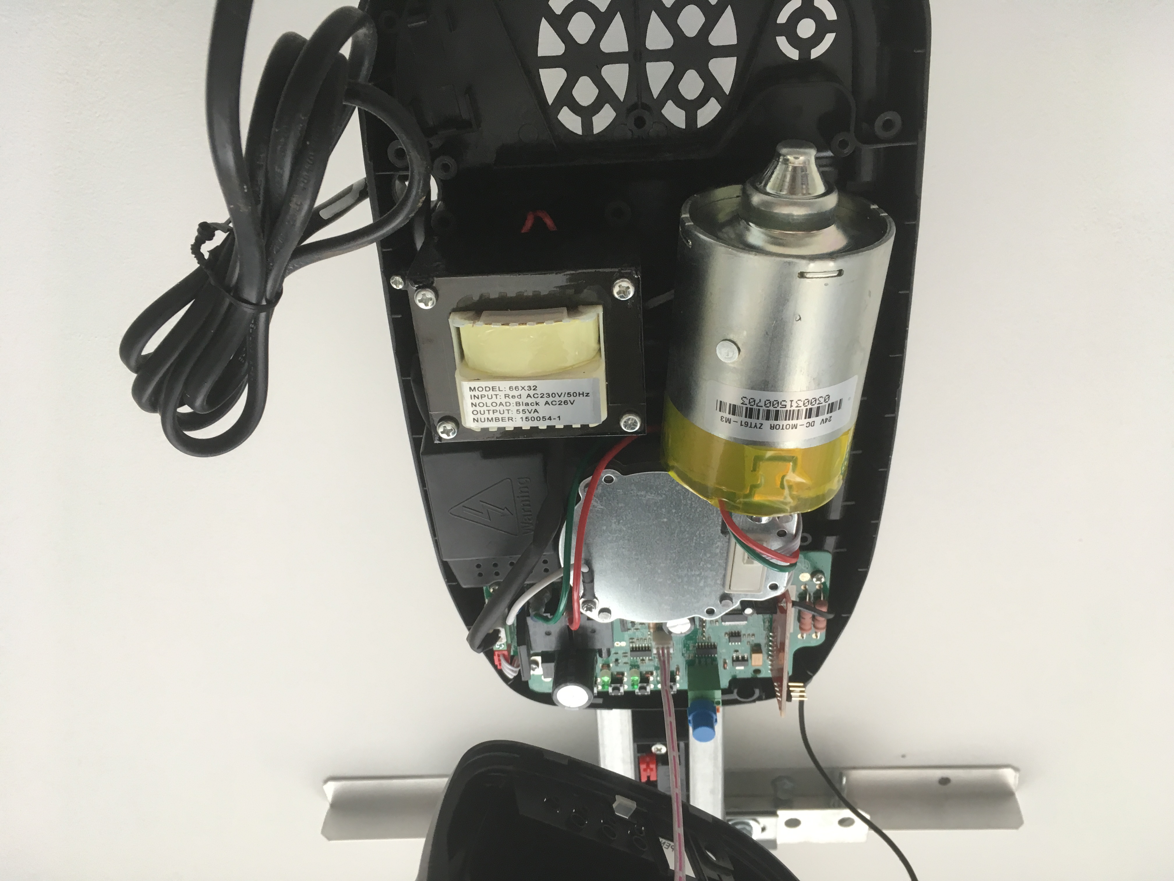

Hello, On most gargemotors there is an impuls connection on the switchboard for external buttons etc. Can you take some more close-up photos of the switchboard itself ? Also is there somewhere online i can look at the manual for this model ?

Please find several photos I took of various parts as I am not sure what I am looking at.

so connection-points 1 and 2 are the ones you need for external control.
Switch Connector 1 and Switch Connector 2 are the ones you need here to connect to your Motor-unit (1 and 2)
Hmm i think he shoud use input 1 and 2 on the terminal block ? (the one under the light blue cylinder shaped cover) maybe this is What you mean ? :sunglasses:
Yes, that’s what I mean, it’s probably a push-button, see page 5 of the manual, actually, the terminal block is above the button, because it is mounted at the ceiling.:wink:

I’m not having much luck. I connected the wires to the plugs just behind the blue switch, not that easy to do, as you said. I then tested the switch by pushing the white button on the Aeotec controller as per instructions and then. nothing…IT didn’t work. The door didn’t open or close.
Ok I think I’ve got it. You guys probably told me what to do but I misunderstood. I removed the blue button from terminal one and two and inserted the wires from the Aeotec into them and voila! It worked. Thank you so much guys for your help.im glad there are people like you to look after the people like me who are tech unsavy. Cheers
