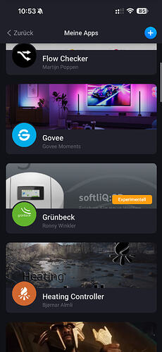

I have a question about the app’s memory usage of 73.2 MB. It seems very high to me. None of the other apps I have installed use that much memory. Is this a problem that only affects me, or does this app actually need that much memory?
Thank you very much for your help!
